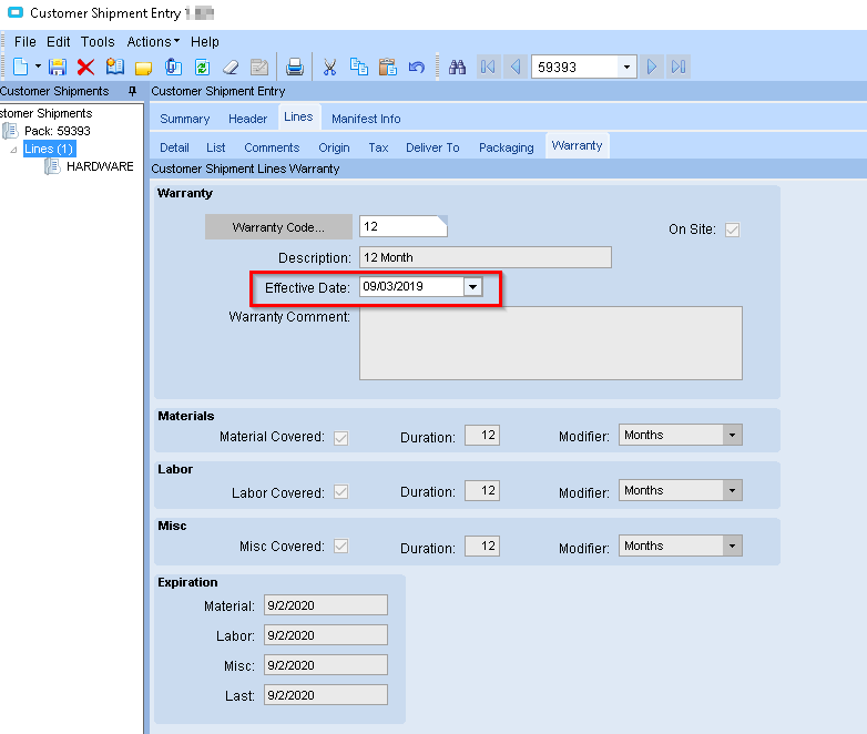

Hi Paul,
The warranty is assigned at the top level part when the pack is created. I’m not sure when it changed but you can now change the effective date for the lines warranty in the pack before it is shipped. I think it was around 10.2.100 or .200 when they added this feature.
As for creating a warranty after a part is shipped I don’t know of any way to do that. What we have done is create a contract type called warranty and setup a contract to capture warranty costs.
I am also working on setting up the use of warranty and service contracts and from my testing you can add the warranty codes to product groups and override the date length if needed in customer shipment entry. There are no way to add the warranty after the order has shipped - unless you maybe do an updateable BAQ (haven’t tried that yet).
