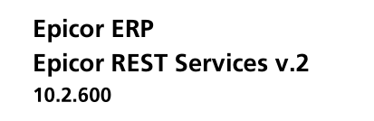

It was released in 10.1.500, but you need to enable it in the admin console. It’s enabled by default in every version since that. On EpicWeb you can download the REST services guide for the version you are on. The current documentation gives some good examples. For more recent versions of Epicor there are two guides one for V1 and one for V2.
