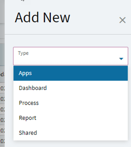

What are the differences between the app types when creating a new app via Application Studio?
I’m talking about these options. I’m mainly using Apps (Erp.UI) but my coworker started an app as a Dashboard (Ice.UIDbd) and it seems to work exactly the same. I’m wondering if there is any advantage or inconvenients by using one or the other. I don’t want to be stuck somewhere down the line because I didn’t choose the correct type when creating my apps because I know you can’t change the type after

Not sure but I think @Chris_Conn is right. Hmm, our list is smaller:
They just have configuator licensed.
Noticed that but we also have Configurator, we haven’t migrated them to Kinetic yet though.
