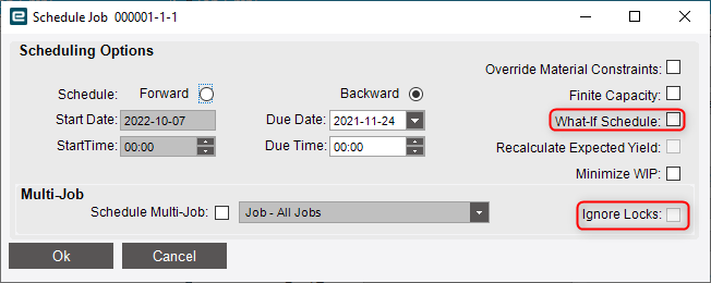

I never tested it, but it may be possible to run global scheduling on What If scenario while simply ignoring locks
Same for scheduling menu from job entry
Edit : typos
I think you can only tun that on if you “schedule multi-jobs”. Right?
Here the field help:
Use the Ignore Locks check box to override scheduling locks. This check box is only available if the Multi-Job functionality is enabled. The default setting is clear, so that by default the locks are respected.
I think you are right about Multi-Job
