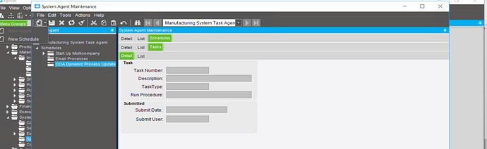

Hi, I checked the System Agent as mentioned, but I don’t have an option to specify which task is to be run. PFA, screenshot for reference. How do I mention which task is to be run?
Thanks.
You have to schedule the task by selecting the appropriate schedule you have setup in the System Agent.
Hi,
Select the process You need to run.For example Multicompany Direct server process .Select the appropriate schedule you created in system agent and check recurring. Once process submitted it will run as per the interval defined.
