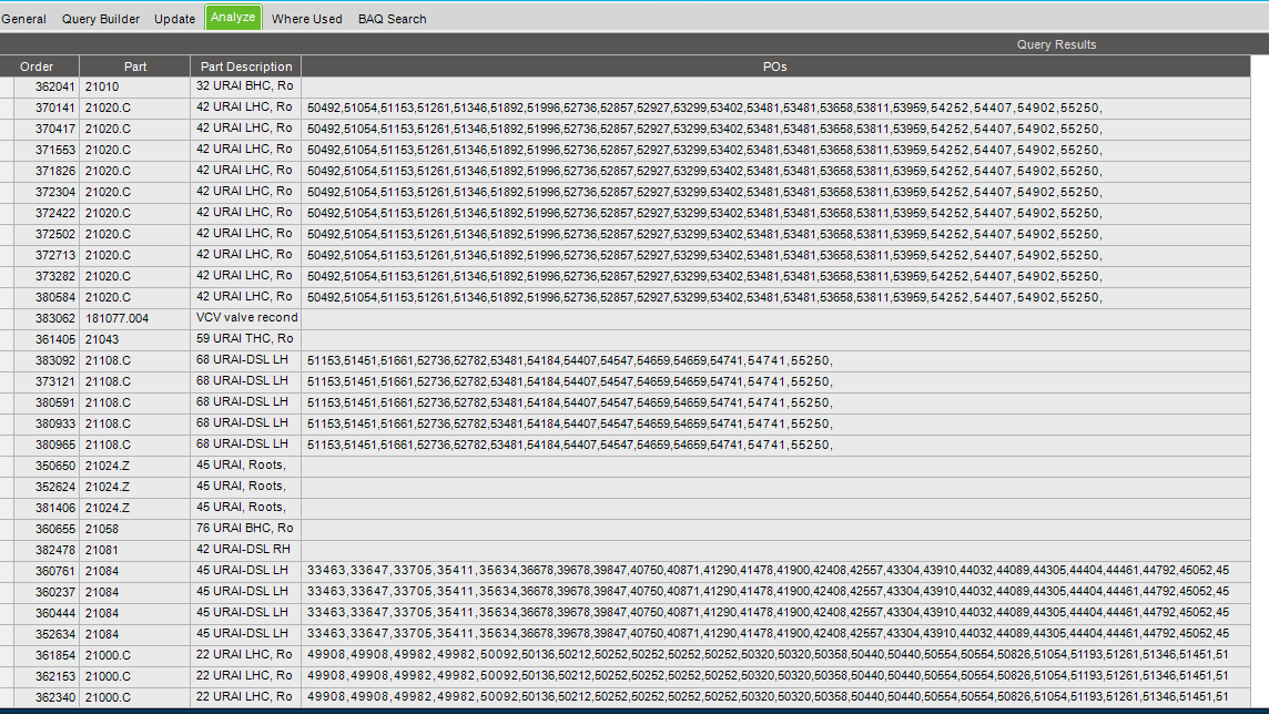

I have created a BAQ to list multiple PO Numbers in one Row, separated by a comma as follows:
I created this as follows:

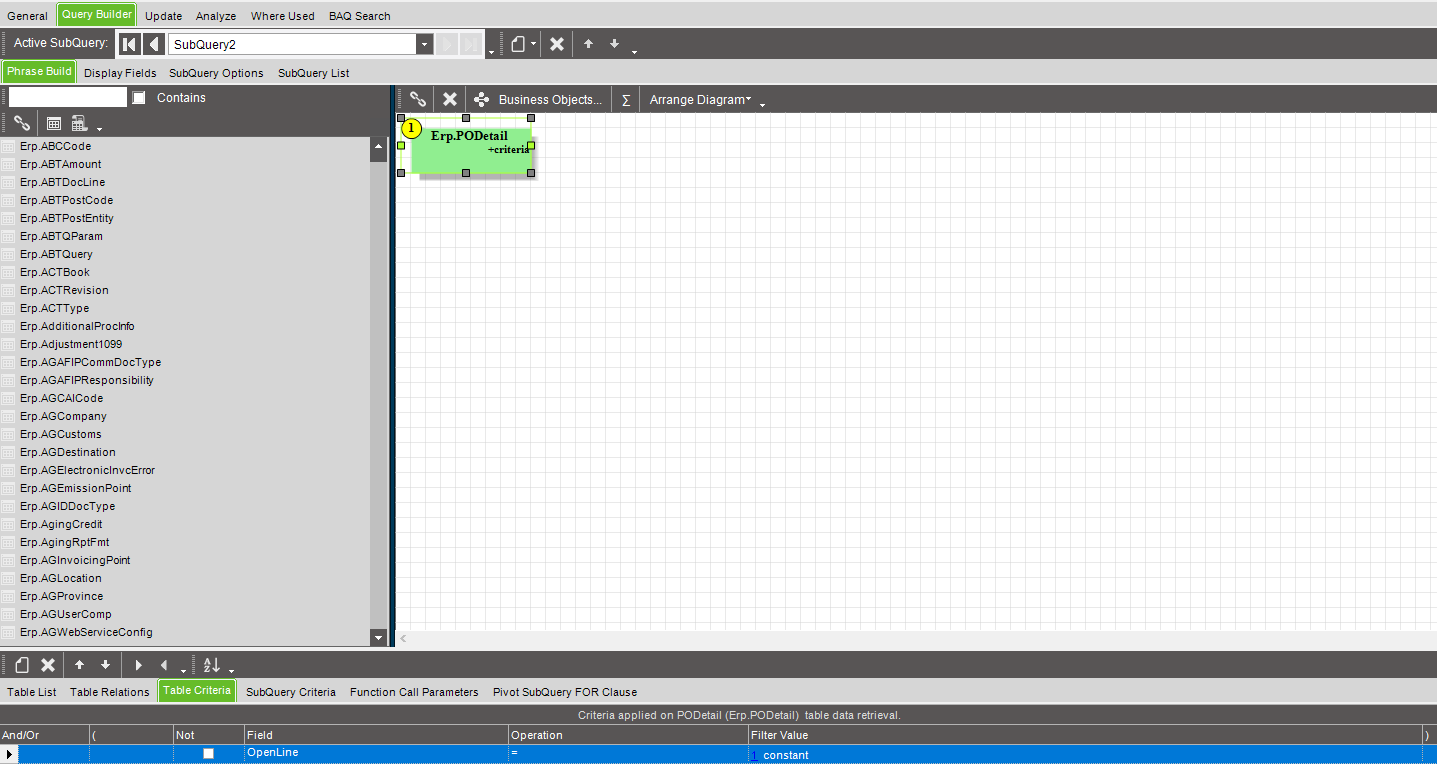

You can add filters to the tables, look at the criteria tab. This will add a where clause to the query.
Brett
That’s what I was thinking originally, but when I try that I receive the following error message.
Severity: Error, Table: , Field: , RowID: , Text: Incorrect syntax near the keyword ‘FOR’.
Am I doing something wrong here?

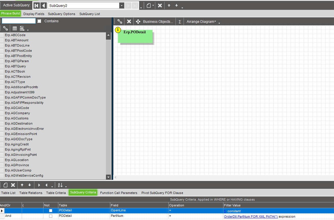

I figured it out! I had to add a SubQuery Criteria (not Table Criteria), and I had to order it before the “FOR XML PATH” expression. Now it’s working perfectly. Thanks for the help!
