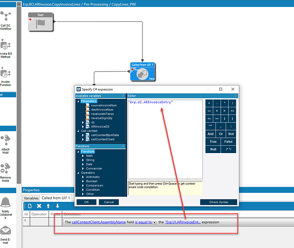

You can check the callContextClient.AssemblyName, but will probably only work from a Method Directive.
Re-reading your post, you’d be better served calling your BPM on the SalesOrder.Update Method Directive and have a condition that checks for Add or Update.
