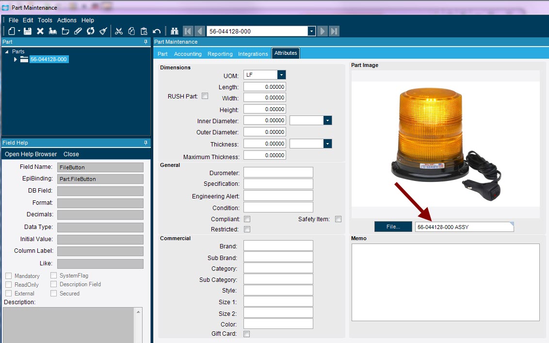

Where are Images Stored
What table are images stored in?
I want to get the file path or the binary file to display on an internal webpage.
I see they are on [Erp].Image but that doesn’t have a path or a binary blob of the file.
