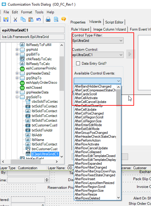

Jose, I am trying to capture the OnSelectionChanged/OnRowSelected/whatever equivalent event for my grid view. That particular event was not in the Form event wizard and it is not a custom control so I can’t use the other event wizard.

Share a bit of the end goal maybe I can help with a solution. Both the Grid Events and the DataView events are available in the Customization natively in the wizard. Have you looked at the wizards yet?
Wow, I thought I had checked all of the events in the form event wizard but I guess clicking in the grid/selecting a row calls the RowChange event. I assumed that meant I had changed an updatable field. I should be able to do what I want now. basically I’m highlighting all the rows that have a certain field identical to the one the user clicked on. Thanks for guiding me towards those again. I had given up on those particular events.
