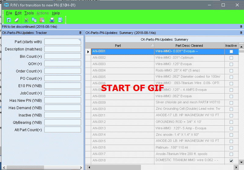

I am trying to find an event that can detect when a row is selected in a dashboard. I keep getting “The name “object_event” does not exist in the current context”
I guess my main question is what events are available to dashboards’ epiultragrids? I read on one of the posts that they are limited. I am trying to detect when a row is selected in a dashboard. The reason being, I have multiple tabs in the dashboard organizing data by filter, and I want to be able to select a row and change a hidden field not useful to see all the time, but used for filtering. We’re taking an excel document that people have used for years and moving it into epicor essentially. Should I cut my losses and change it from a dashboard to something else?

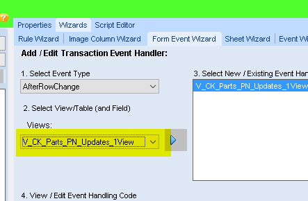

Us the Form Event Wizard (Not the Event Wizard).
The “view/table” to select is the query source for that panel of the dashboard.
