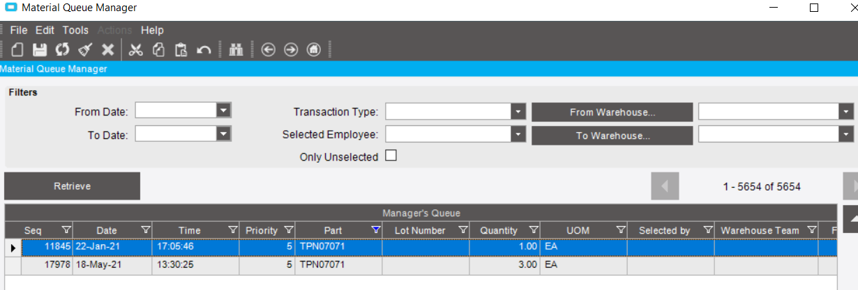

Why are there entries in the material queue manager
We have the Advanced Material Management module (AMM) but I didn’t think it was in use. We went live in DEC '20 and there are 5,654 entries
Only came across this when trying to inactivate a part.
Just wondering why stuff is getting in there as no member of staff is monitoring this to clear out

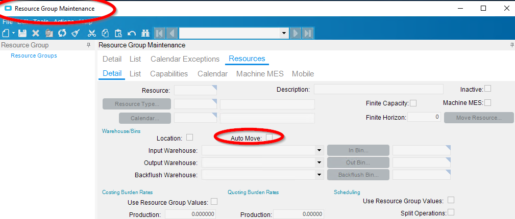

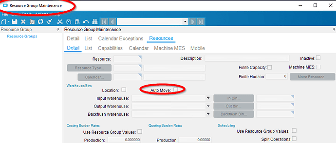

when people complete an operation there is a checkbox to request move… that checkbox defaults to TRUE unless you have set the resources to AUTO MOVE. if there is a request to move, it automatically loads to Queue…
if Auto move is turned TRUE, then it will automatically move the job without a queue entry being created.

One of the columns in the material queue manager should be TranType. That will tell you what type of transactions they are related to so you can better investigate where they are coming from.
Thanks Andrew. They are all PUR-STK.
That means they are coming from the PO receiving process. Under site configuration you setup your default receiving bin. That is where the inventory goes when received. There is then a PUR-STK transaction that hits the material queue to move the inventory from the default receiving bin to the primary bin setup for the part received.
