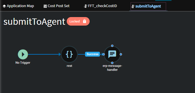

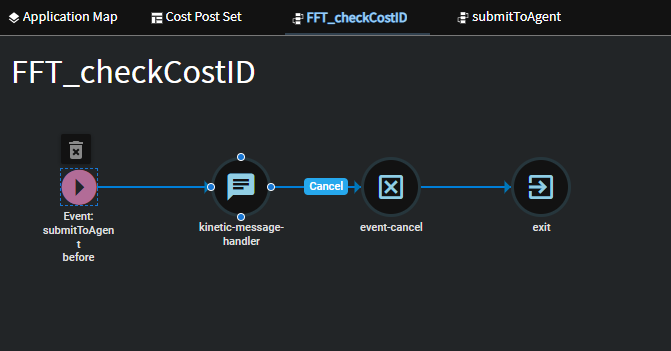

I created a BPM that calls a BPM form giving the user the option to cancel or proceed on Post in costing WB. The kinetic form would send the toast popup that it was posted even when it was canceled…
Similar issue where it reads as a success even when it was not.
So, I created an event in the application instead and am forcing users to use kinetic for this :slight_smile:
Similar root cause?
