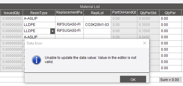

Recently I has created a UDForm which attach the UltraGrid with some field to edit and update, I has set few as read and edit, and I did attach the valuelist on the cell in order for user to select from the list.
When I try to switch/move my cursor to another cell it prompt me this error, is there any way to validate or ignore the error?

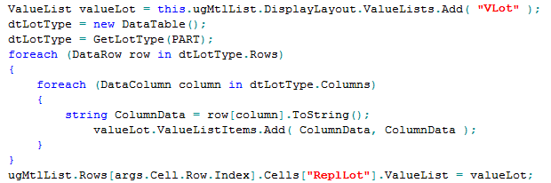

My cell ReplLot has valuelist attach as following, and may I know is there somewhere I miss out?

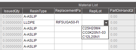

and I able to prompt my list after the code.
