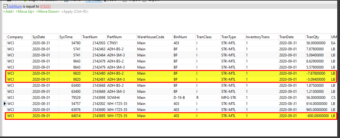

@jgiese.wci - quick question about the Part trans for that job.
From your screen shot:
Why the negative STK-MTL transactions?
Also, I always sort parttran by TranNum. Give you a better view of the order things really happened in.
The first two are backflushed why they are negative no idea. The last one they returned the remaining roll of paper from the job.

When material is backflushed, any change to a labor record (recalling, changing, and submitting again) will cause a negative STK-MTL to back the old backflush qty out, then a new positive STK-MTL transaction with the new backflush qty.
EDIT: As of 10.2.600.3, it looks like this is no longer the case. Back on 10.2.300, this was true, but looking at some part transactions from last week, I’m not seeing the same behavior. Now, Epicor is making a differential entry instead of reversing the old entry and entering a new entry for the total amount.
