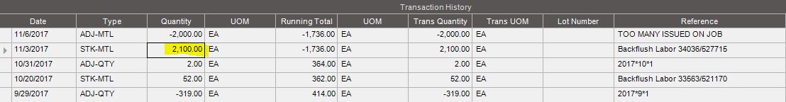

So, we have part that had a transaction of 2,100 for Backflush labor. but, according to my engineer, it should only of been 100. So she went and tried to correct it with the 2,000 on the 6th, and that did nothing to solve.

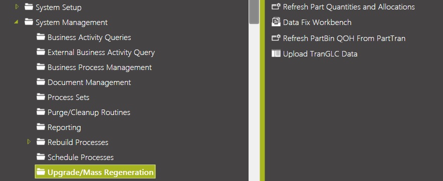

Refresh Part Quantities and Allocations
@Mark_Wonsil Did that this morning to no avail.
The easiest way to fix this is to find the offending labor transaction and adjust the qty in T&E if you can. It will back out the inventory and costs all on one transaction. The caveat is, you have to do this before the transaction is posted (I think).
Yeah you do. Interestingly, the labor looks good. It seems, it posted and then someone changed it somehow. While it worked for the Job/accounting, it didn’t work for the transaction history. So I have this mess.
Rephrase: labor was probably logged incorrectly on the related operation or someone went in and changed the engineering after labor was logged and the backflush completed.
