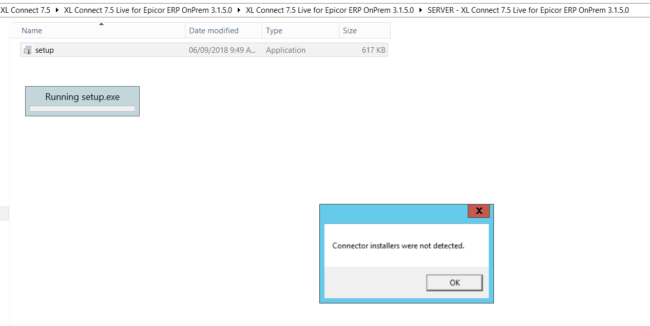

Dear experts, When we are trying to install the XL Connect 7.5 on server system is throwing error “Connector installers were not detected”
Please suggest or guide how to resolve this issue.
You have to First install the XL Connect For Epicor ERP 3.1.7.0 Connector Installer.
