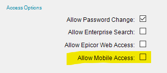

This morning I deployed Epicor Mobile Access extension to see how well it worked on a mobile device. After deploying I went to the URL, added my user/pass, then got:
“You are not enabled for Epicor Mobile Framework”
Is this a licensing issue? In licensing, I see MobileConnectiOS and MobileConnectAndroid (both non-licensed). Is this why EMA gives me the error above?
Did you add the permission to your user account?
Okay, that got me in, but now I’m confused. I don’t see any forms (like order entry) in EMA. Is EMA only for custom-made web views? (and then EWA for the stock web views?).
