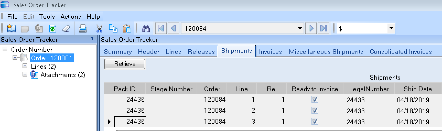

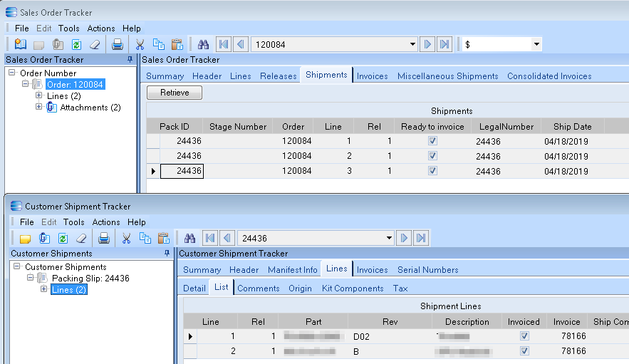

@ckrusen they all shipped on the same pack slip, although looking at shipments was quite interesting as it shows 3 lines where there are only 2 lines on the order. I suspect this is a clue / related to the problem. Any ideas?

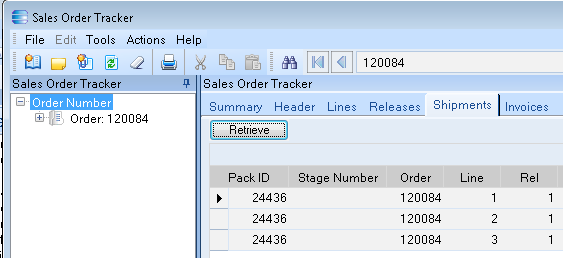

In the screenshot below it shows there are only 2 lines on the order, but three lines on the pack slip. Is this sufficient of a check?
Any suggestions as to what to look for on that sales kit that could result in this problem?
What does the Packer show? What’s the P/N of line 3 on the packer?

@ckrusen if I open that pack slip in customer shipment tracker it only shows 2 lines. This appears to conflict with what I see in sales order tracker, it shows 3 lines… Any suggestions?
Somehow, a component of the SK is creating an invoice on its own.

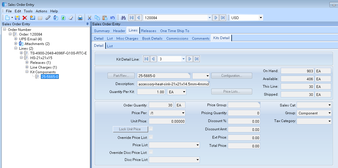

Like I said, the components of a SK are stored within the OrderLines. That Line 3 you see for Order 120084, must be a component. It’s odd that it only created 1 line - unless your SK has just one component.
Can you post the SK details ?

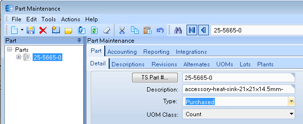

@ckrusen you are correct there is only one material on that sales kit. That part is the part number listed on the $0 invoice.
Is that s mfg’d part?
And what shows under the Part-> Sites -> Sales Kits tab?

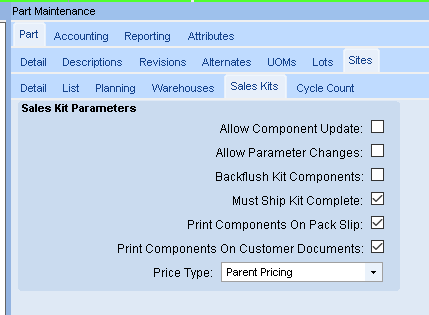

Sorry I don’t know a lot about part setup, but below is the screen shot for the sales kit and the component in the sales kit. Really appreciate your help!
Looks like a purchased part.
The “Allow Component Change” option (from the field help):
If you select this check box, users are able to update kit components when entering a quote or sales order for the kit. Fields on the Kits Detail sheet in Opportunity/Quote Entry and Sales Order Entry are enabled to allow changes to kit components.
But the screen shot of the Order shows the Kit’s part wasn’t changed (assuming 25-5665-0 is the part specified in the SK’s BOM).
We don’t use Backflush components, because we stock in several bins, and need to specify the Bin the part comes from. This is done during Packer entry.
And “Ship Kit Complete” should have prevent the components (even though you have just the one) from going out under different packers. Plus, you Invoice shows them from the same packer.
It would appear everything looks setup correct.

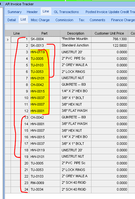

FWIW - I see that our invoices for shipments with SK’s on them aren’t exactly as I’d expect.
The following is for an invoice for two lines, each being a SK.
Notice that the only invoice lines with a non-zero cost, are the two SK P/N’s.

Maybe during Invoice creation, the AR person deleted the $0.00 line. And then the system thinks, “Hey this item hasn’t been invoiced yet, I’d better create a new invoice for it!”
There is only 1 packslip, there should only be 1 Invoice. How many invoices are there? You can suppress the component at zero dollars if you uncheck Print Components on Customer Documents.
Hi Cathy,
We have 1 packslip, but 2 invoices(see screenshots below). The sales kit didn’t have the Print Components on Customer Documents checked in the Part Entry screen, and the component itself had the checkbox greyed out. Am I looking in the right location?
