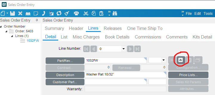

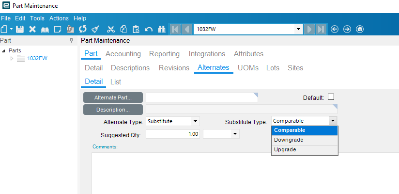

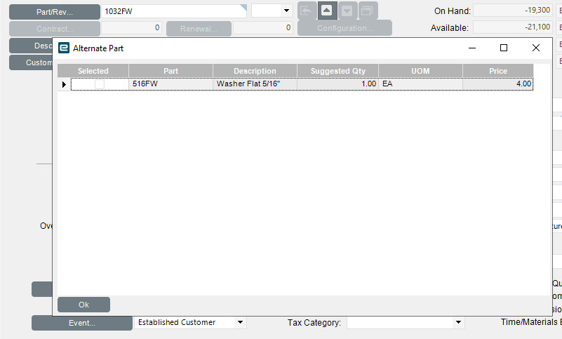

If so, Epicor DOES have a built-in feature for upgrades called Part Alternates
When there’s an available alternate part, Sales Order Entry activates buttons:
Selecting the sub, upgrade, or comparable button allows one to switch out the part on the order.
@Mark_Wonsil , I think he means swap out a component in and assembly for an upgrade. Not total part alternate.
