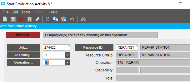

Out-of-the-box Epicor has no restriction on the number of people who can simultaneously be clocking labor on any particular operation. When the second person tries to clock in, are you getting an error message?
Ernie so even without an operation having crew size 2… multiple people can start activity on the same job, op?
when clocking in to a job that someone is already clocked to, base epicor will have this red message at the top but nothing will stop the employee from clicking ok to start production activity.
@embedded just to clarify, you are using MES for clocking?

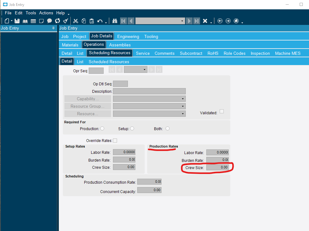

@hkeric.wci Crew size wont impact this. crew size is used for capacity planning if running finite capacity on resources.
and it think it uses crew size when calculating estimated job cost, not 100% sure on that one though.
Try changing your crew size on this job/operation. Then see if they still get the message.

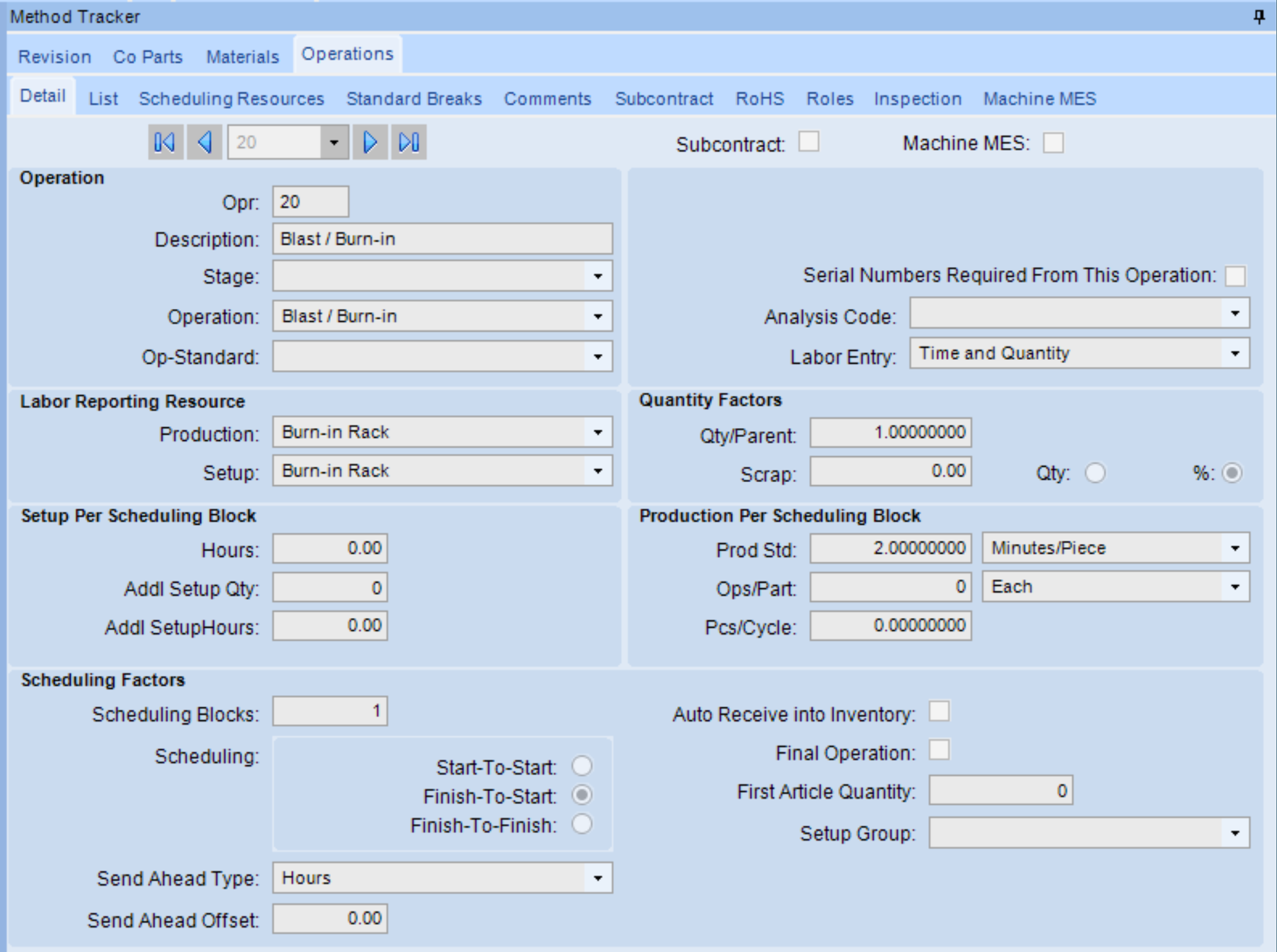

How are your resources and operations set up?
@craig I’m not familiar with resources in Epicor, it sounds like this is something I should be familiar with so we can review how it’s setup. From a 50k ft view what do resources do in relation to labor on jobs?
In regards to Operations, I assume you are asking what Labor Reporting Resource we are using. This is something that was setup when we went live with Epicor ~10 years ago and I don’t know what it does. It sounds like I need to read up on resources in Epicor and how they relate to operations and labor. Any pointers on these topics would be greatly appreciated.

Resources/ resource groups are where capacity lives (if you ever run a finite capacity shop). Resources are the where / who is doing the work. resources / groups are site specific.
Operations are the Verbs. The actions that are being done. operations do not have to be site specific.
Operations will use the resources to build the schedules. If you click that Scheduling resources tab you can see where that particular operation wants to be performed at. also right click the operation and open operation entry and you can see the resources/ resource groups associated with that operation. then you can open up resource groups to see how those are structured.

Correct. The flag @Craig shows is a warning message, but it won’t stop anybody from doing anything.
I think my personal record is 4 operators (with the resource group set with a crew size of 1) clocked into a single “assembly” operation simultaneously.
There ARE costing implications (split labor/labor=burden), so this should be tested with the Finance folks to make sure they know what’s coming.
@embedded Try changing the crew size in the Scheduling Resources tab of a job:
Note that as @Ernie said, this will affect job costing.
