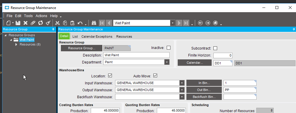

the request to move puts it into the material move queue. Then when you go to move it, it brings up the receive to inventory screen instead of just move. That’s a default that is set in the resource group I think for whether it’s checked or not coming out of an operation. It’s interesting to know that you can get it to do that for non-excess completions. Although I’m not sure I want to turn that on for us, and that seems a little dangerous.
