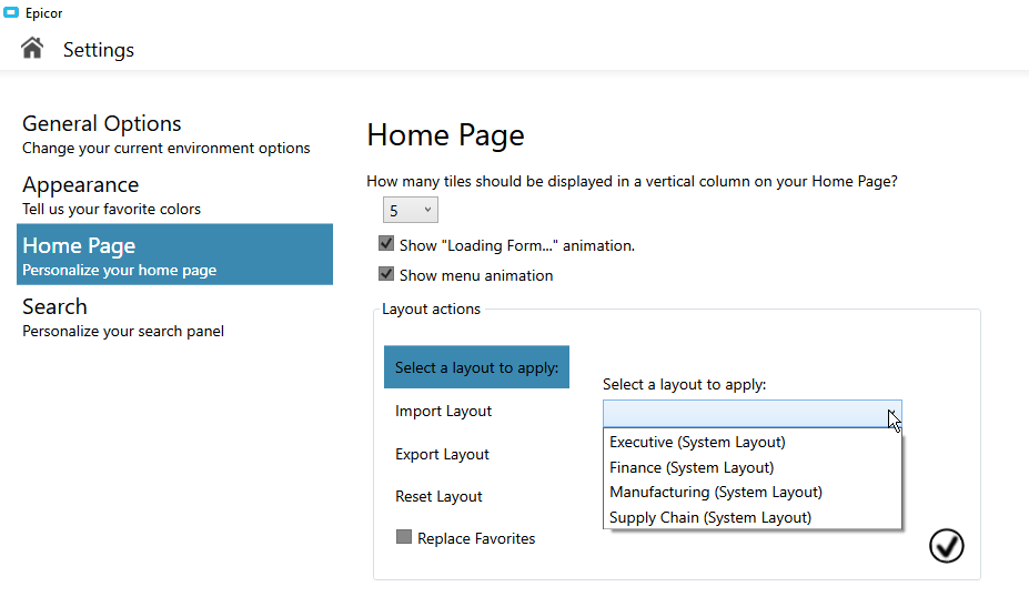

you have to pick a layout. And all the license does is make it so you can make your own views with your own BAQ’s. You should be able to get a view with stuff in it without the license.
and when you say blank, how blank? Like there is nothing to pick anywhere? Or just the main canvas. Here’s what mine looks like now.

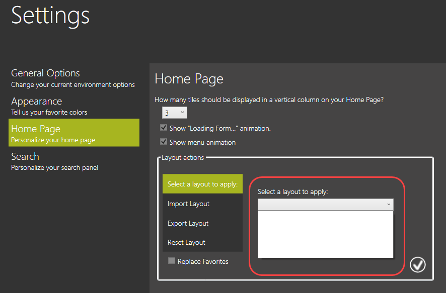

so I have redeployed EDD in the EAC but when I log in there are no layouts to apply in my listing? its blank… has anyone seen this before?
The system layouts are only visible to security managers. The idea is to deploy custom versions of them with security that you configure - this way they won’t get overwritten by Epicor in the future.
