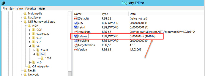

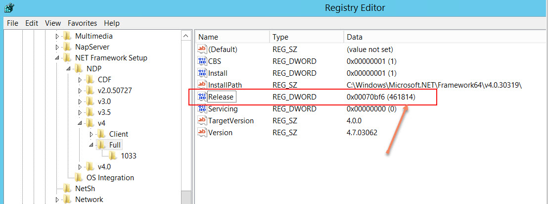

Although, it did allow me to install the software, register databases, do the pre-migration, etc. But only failed once it reached Generate Data Model. ( IMO, there should be something in the installation to check for this.)
BTW, 4.7.2 is Release values of 461808 or 461814.
