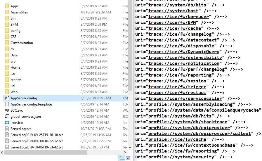

Turn on the hosting trace flag in appserver.config. That will show you the process of deploying the data model to the app server from the db and give more details
Thank you Bart,
I have been running some traces but so far do not see anything related in them.
I cannot find an appserver.config file anywhere on the server or within the client files. I can find app.config in the Deployment directory but maybe I’m missing something here…
I am running the trace from Trace Options in the client with “Include Server Trace”.
Any further hints would be appreciated.
Pat
Hmm interesting, it should be there wherever Epicor is installed (IIS Location):
Losing my mind. Sorry. I just found it. Thanks

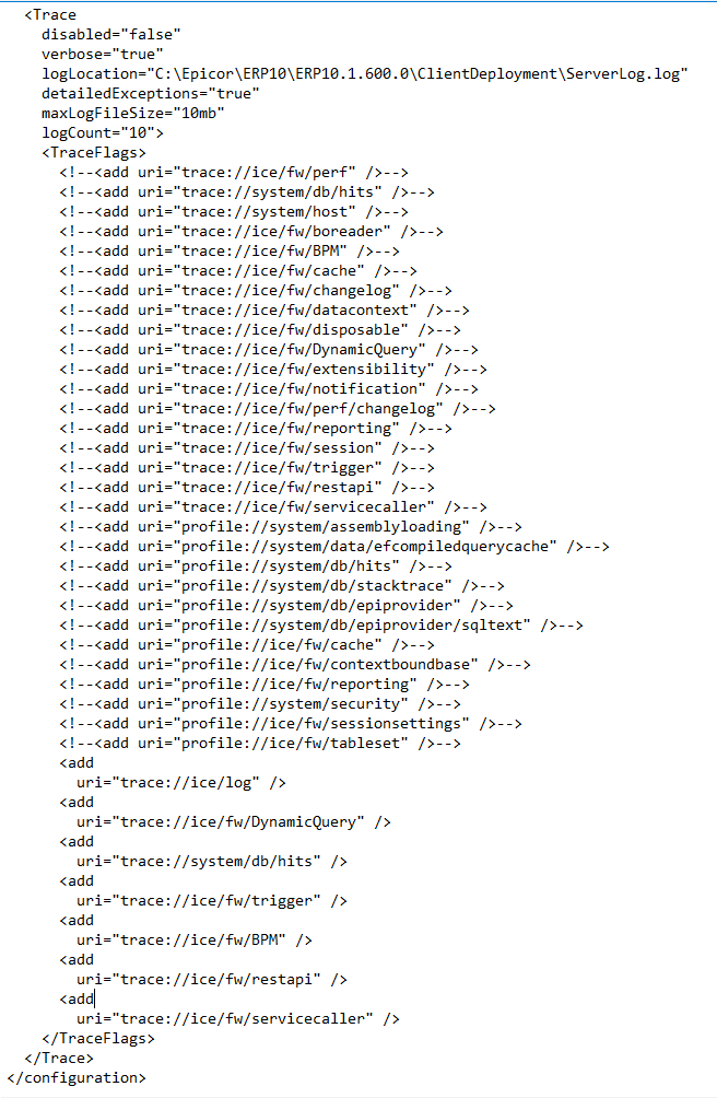

Bart,
I see a thread you did about “How to write your own trace log” but it sounds from your post like you are saying that I can just turn on the Hosting Trace Flag from within the AppServer.Config file.
I’m looking in that file but do not see that TraceFlag. Do I need to create it ?
It might just be the system/host one – just remove <!-- and -->
Correct on which one Haso. Apologies for using short hand for the name.
