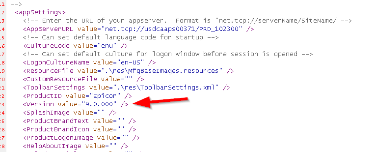

Well, I did find one sysconfig file that doesn’t specify the proper version …

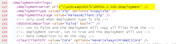

We’ve NEVER had version 9. Went straight from 8.03 to 10.1.400. and that was on a different server. The App server that this sysconfig file points to has only ever had 10.2.300. As shown by a later part of the sysconfig file:
Hmmm… similar. It’s weird that on brand new deployments it’s inconsistent. I could see through an upgrade or if the deployment server was different. But new servers and same deployment URL. You’d think they’d be the same. Wonder if there is something else I’m missing here :thinking:

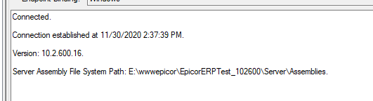

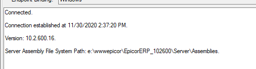

Have you redeployed the Test app after running whatever updates / builds might have been done?
What shows as the version for Test in EAC?

I have not. All four environments where installed as base 600 then updated to .16. The database of all of them were copies of our 10.2.400 and upgraded to 600 via EAC.
PROD
TEST
