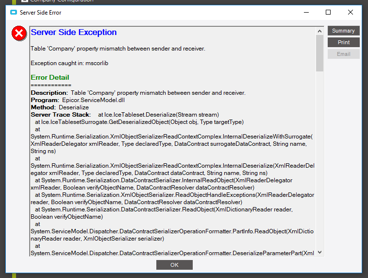

I noticed it first when I went in Production and tried to access company config and got the following errors. It will eventually open but with a not data. (I get the same error when I open PO Entry)

The Error means your Client and Server versions do not match. Make sure your Client is updated.
2nd possible reason is if you used Industry Extensions and you migrated to 10.2, you have to change to the base Company Form, or get rid of Server Side CSG (IEX) dlls.

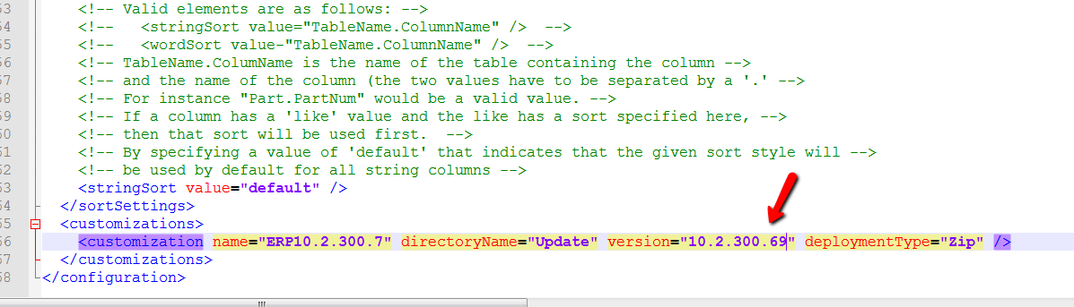

It may have not updated properly, go to your config on your client change it to version .81 and itll auto-update again.

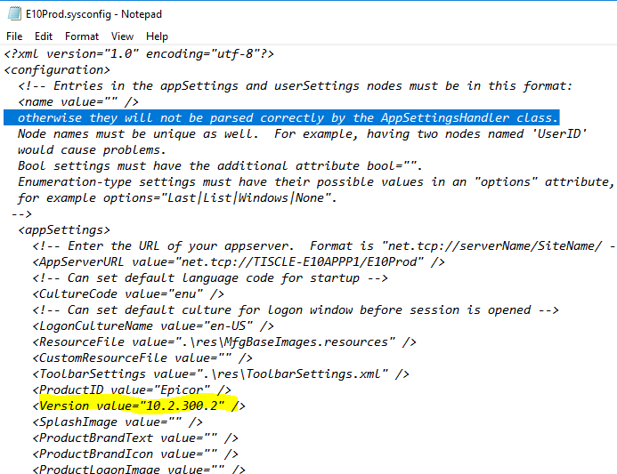

Where do I need to do this? I opened my E10Train.sysconfig file…but value do I need to update.

Once you save and re-run Client it should re-trigger Auto-Update.

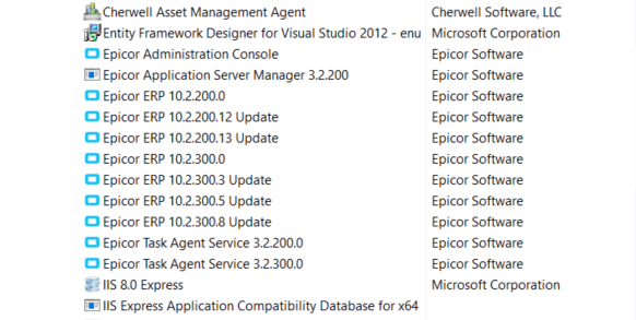

So little to my knowledge…I am sure some are going to face palm on this one…I installed 10.2.300.8. I figured we don’t need all those other update installs on the server…(I know…:roll_eyes:)
So i removed 10.2.300.2 and a few others. Well you can’t do that…

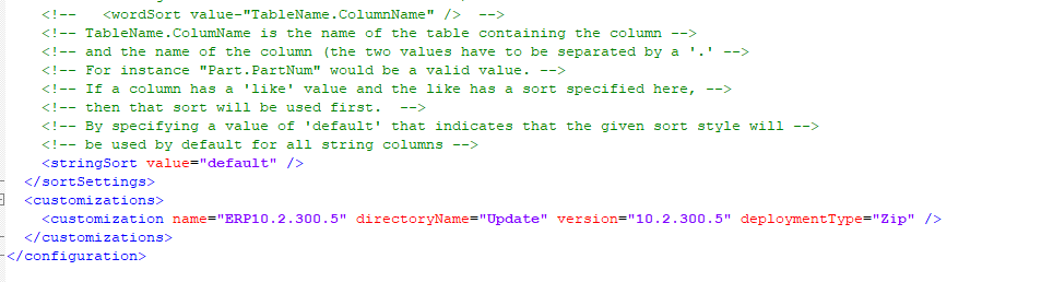

When I look at the config file the version value is set to 10.2.300.2 (I removed 10.2.300.2)…
So I changed the value to 10.2.300.5 (the version that environment is on)…it updated and everything worked fine. (but the sysconfig still reads 10.2.300.2…:thinking:)

I really think it was something with me removing the Updates on the server…no more 10.2.300.2…now I am second guessing myself. I have 2 servers one has 10.2.300.2 installed and the other does not…I can’t imagine I would remove it on Prod server and not the other…SIGH

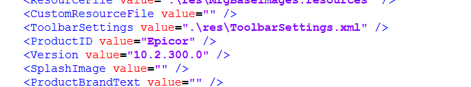

Did you start with 10.2.300.0? We went live with 10.2.300.5 so I don’t know why my versions say 10.2.300.2.
