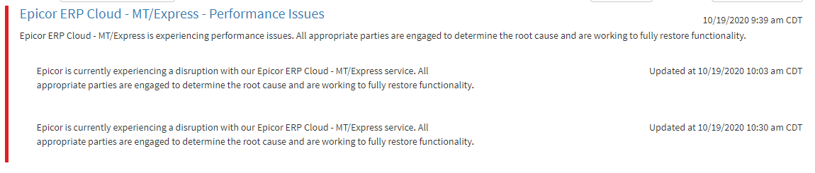

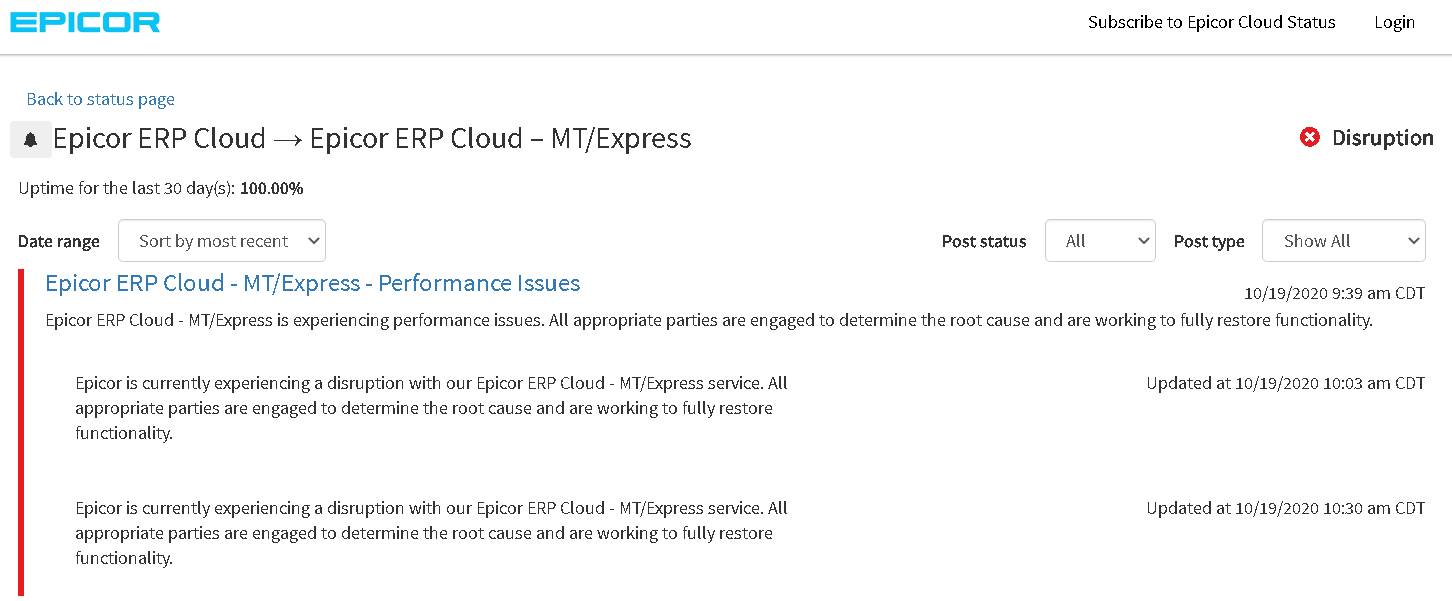

It seems you’re not alone. Well, MT/Express users. Other Public Cloud users (Dedicated Tenants) are not seeing this disruption.
Mr. Mark: Thank you, I forgot about the Status page. You are the MAN!
