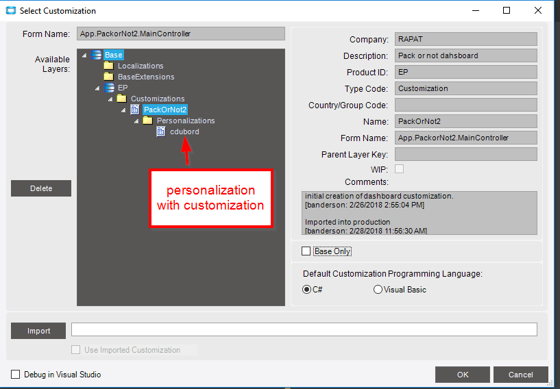

Throwing this out there in case you don’t know (you maybe do?) Personalizations are customization specific. So if you add a customization, they lose their personalization. It’s annoying.
But they should be able to create a new one on top of a new customization. Is that what you are having problems with?
I have seen issues with Save Layouts & Personalizations in 10.2.100.9 - .12 and guessing it is present in earlier releases as well. Save Layouts works fine on a base menu item but not a customized menu item. I also noticed that before when you could make changes using Save Layouts, go into Customization Mode, and save (to save the layout change) do not work any longer as well.

IF there is a customization, then associated personalization(s) will not load
IF only the base form, then associated personalization(s) will load
