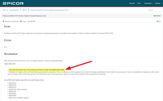

@Vitesse is it the same fix that Epicor is providing or no?
Microsoft created one work-around. Different MSI installers for different versions of Windows 10. Both 2W Technologies and Epicor received the work-around files for testing. Then after observing the performance improvement (and learning the long-term solution would take some time to be developed) I requested permission from Microsoft to re-distribute the work-around.
I have the slowness issue fixed with the work-around MSI file on my system, but I still have the drag issue
Hopefully it will all be fixed in July…
