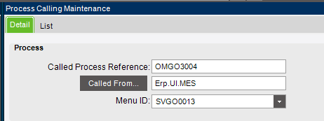

I was originally looking on this site to see if anyone found a way around for the time being. Process Calling didn’t seem to work, but maybe I entered it wrong. Does anyone know if that works using Kinetic UI?

Here is the Process Calling I was trying, but the Call From is Invalid to Epicor, but is what is in the process menu. I assume this is not working for Kinetic.
