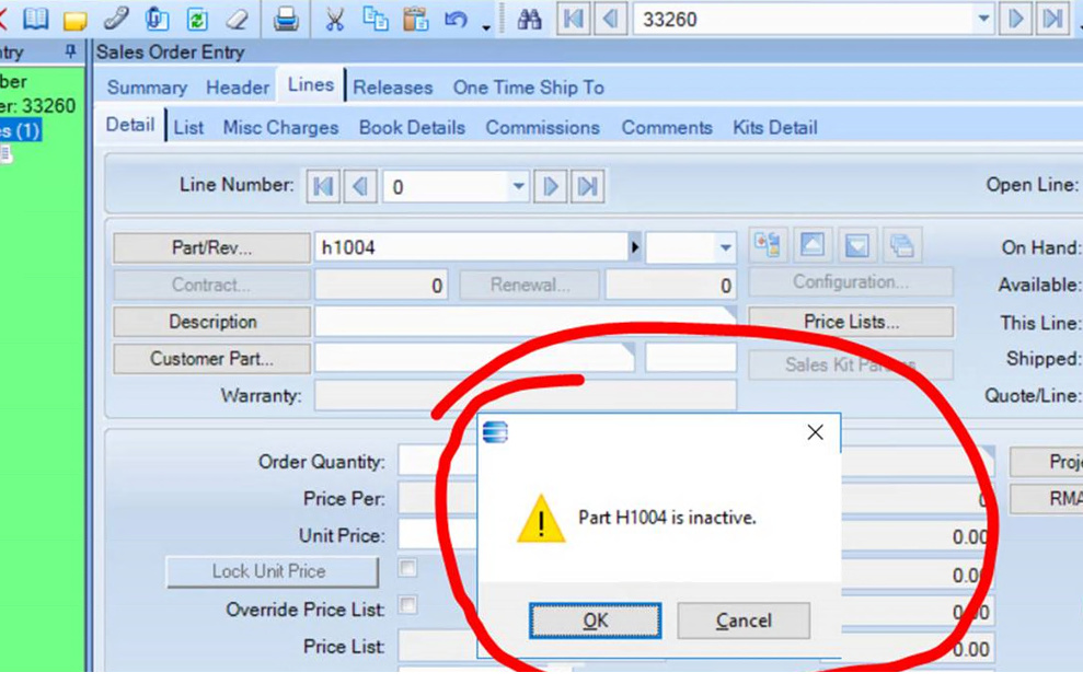

After testing - this message appears - (which i think is system generated because i can’t find a bpm that has been written)…but if you click “ok”…you can simply proceed.
What i’m looking for is IF the part is inactive…then stop altogether
So what I’ve found from the below testing is that:
  1.  When creating a SO and you use the search button – inactive parts don’t show up…..(see screenshot below).
  2.  When you just type it into the part field (without searching)….it recognises that it is inactive and the processor is prompted to either click “ok” or “cancel”. Ok lets them continue.
  3.  The message that appears is not a bpm setup by Prior. It seems to be a system built notification.

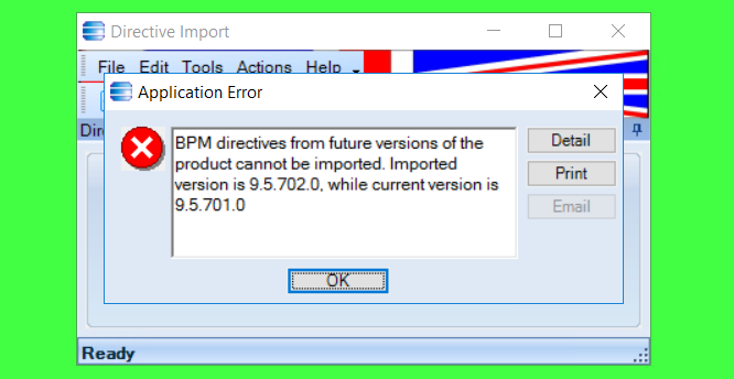

Thanks Greg,
Only 1 glitch - i can’t import it as were on different versions.
Is there any chance you can send me screenshots of what you’ve done to get this working?
Many thanks.

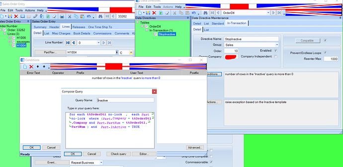

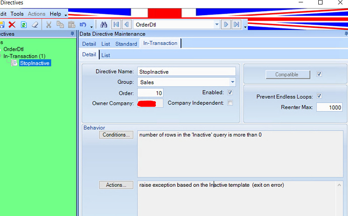

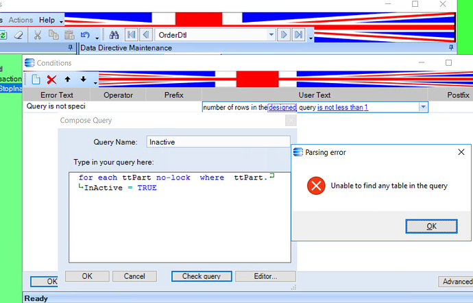

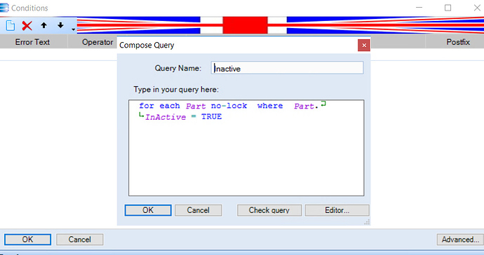

Just having a practice on a data directive…the below works to a point but it errors on EVERY part i type in, in-active or not.
It is also extremely slow when you click save.
Hi

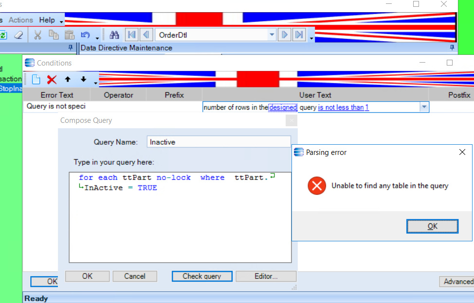

You’re checking against the Part table, check against ttPart instead. It’ll be slow because you’re checking all your hundreds or thousands of parts.
Regards
Mark

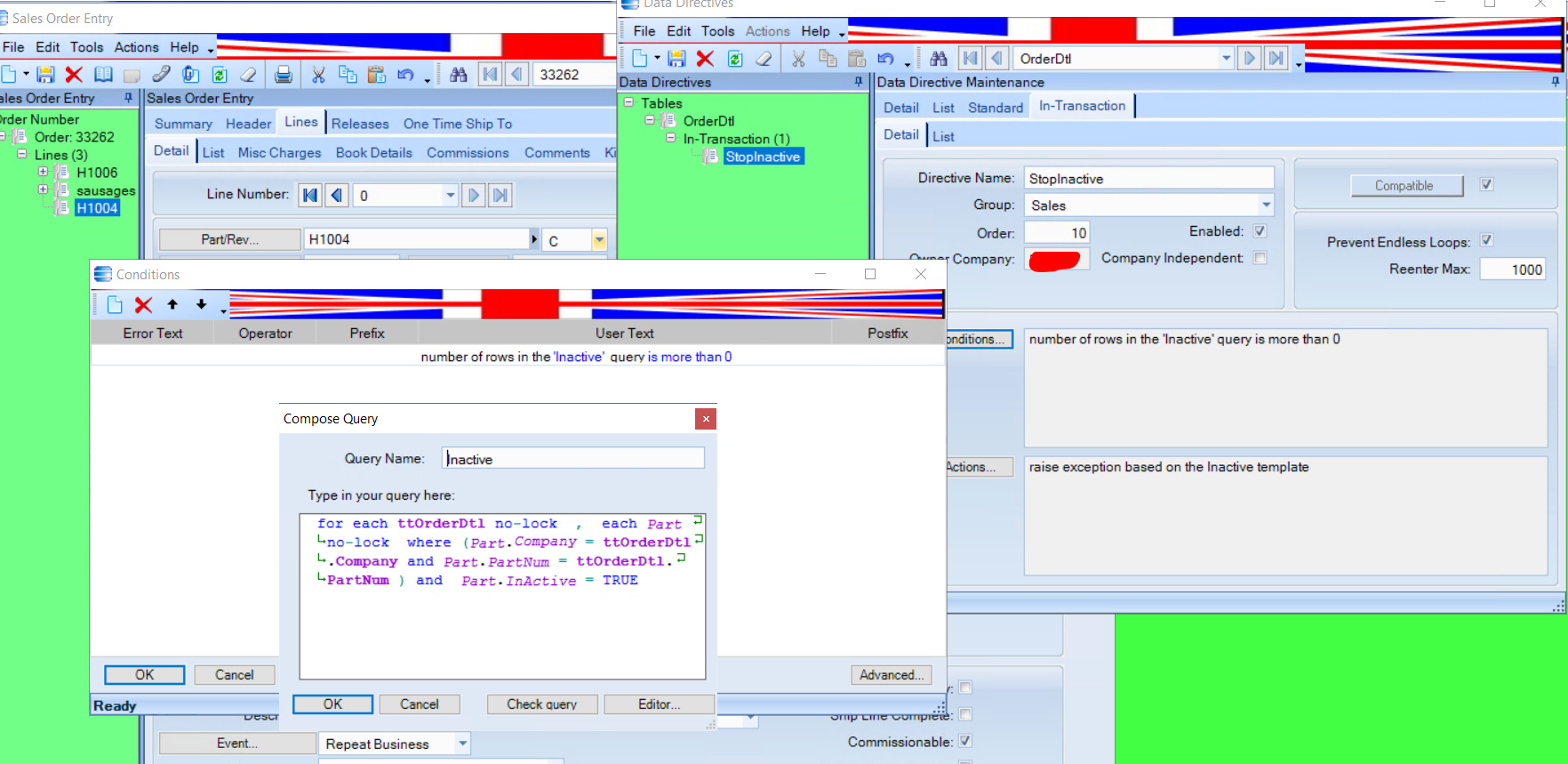

Hi Mark,
This seems to have done it.
Perfect – sorry didn’t properly look at which screen you were on, but hopefully steered you in the correct direction.
Here is the ABL code I used. It is essentially what you came up with.
In Salesorder.Update.
/* check Inactive */
define variable Msg as character init ''.
For each ttOrderDtl.
	For each Part where ttOrderDtl.Company = Part.Company and ttOrderDtl.Partnum = Part.Partnum no-lock.
			If Part.Inactive = True Then Do:
					Msg = "Part is Inactive, Cannot be added".
					{lib/PublishEx.i &ExMsg = Msg &ExType = {&MESSAGE_ERR}}.
		  End.
	End.
End.
In Sales Order.ChangePartNumMaster
For each ttOrderDtl where PartNum = ttOrderDtl.PartNum.
					ttOrderDtl.PartNum = ''.
					PartNum = ''.
		  End.
	End.
End.
