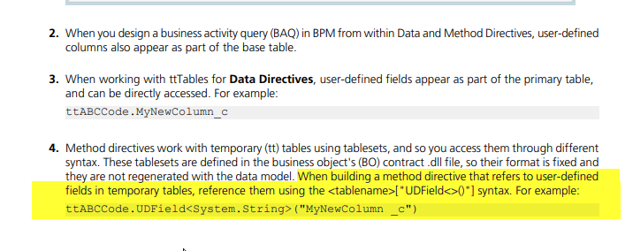

On converting the ABL to C Sharp BPM Code Conversion, the UD Fields Shortchar01, 02…
not available in ttTable getting an error and when we use Db.Table the Fields are available without any issues.
Have anybody faced this issue
Below is an example
From DB this worked
var vShipDtl = (from xRow in Db.ShipDtl where xRow.ShortChar02 == “” select xRow)
From ttTable this is not working
var vttShipDtl in(from xRow in ttShipDtl where((xRow.RowMod == “A” || xRow.RowMod == “U”) &&
(xRow.ShortChar02 == “” || xRow.shortchar04 == “”
Thanks,
Take a look at the Programmer Guide in Epic web it covers all this in detail regarding the ABL to C# conversion and how to do it.
https://epicweb.epicor.com/doc/Docs/Epicor10_ConvertedCode_ProgrammingGuide_102600.pdf
Try using the format shown in the “C# Programming Guide (conversion from ABL)”
try this:
var vttShipDtl = ttShipDtl.Where(x => "AU".Contains(x.RowMod) && x["ShortChar02"] == "" || x["ShortChar04"] == "");
