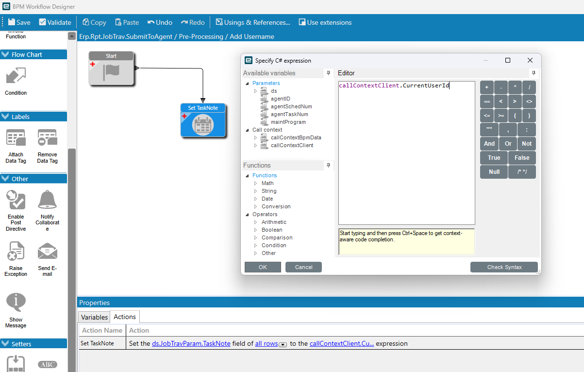

Create a pre-process Method Directive on Erp.RptjobTrav.SubmitToAgent. This would set the TaskNote (User Description on the screen) to the current user:

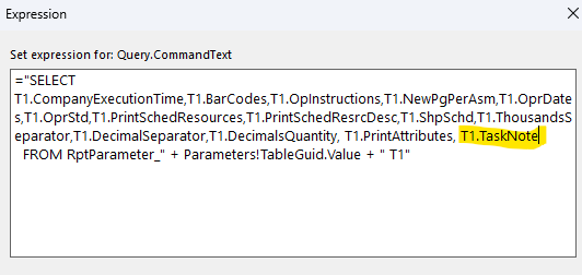

In your SSRS, add TaskNote to the RptParameter table:

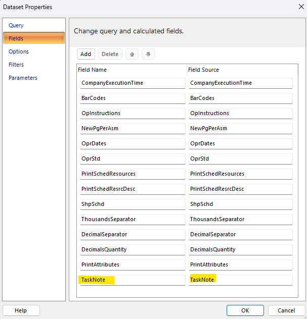

Add it to your field for the RptParameter Dataset
Finally, add the field to your report. I chose TaskNote because it was easy, but users must be aware it will be overwritten. Anyway, it might give you a path forward. When you look at the System Monitor, you should see the submitting username in the User Description (TaskNote) field in the History tab if the BPM is firing properly.
