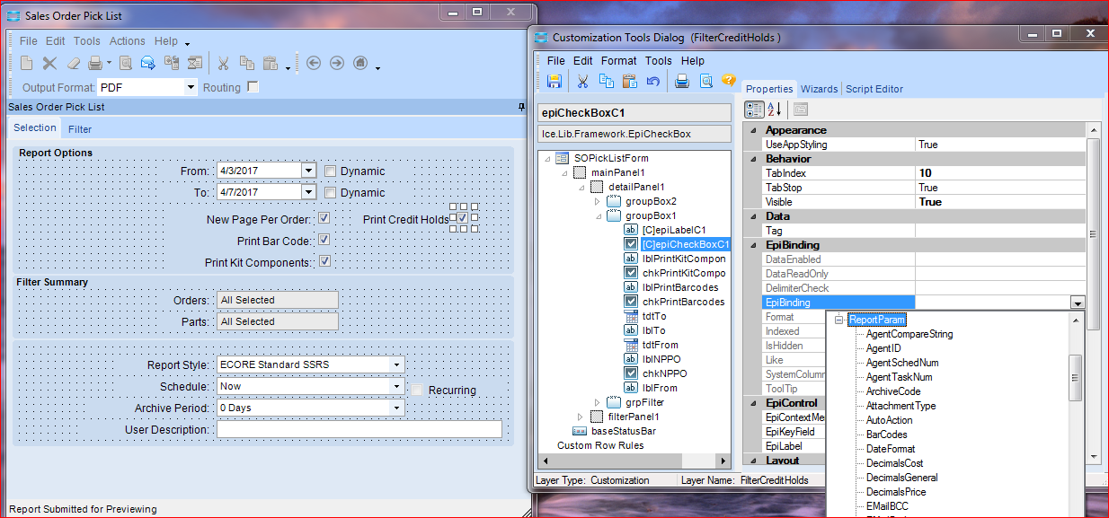

I believe there were some UD fields in the ReportParam view in E9. Has any one found a way to add them in E10 and pass them to the reports?

Rich, I bound the custom checkbox to CallContextBpmData.Checkbox01 and previewed the report. Now, where can we access this field in Reporting Database?
