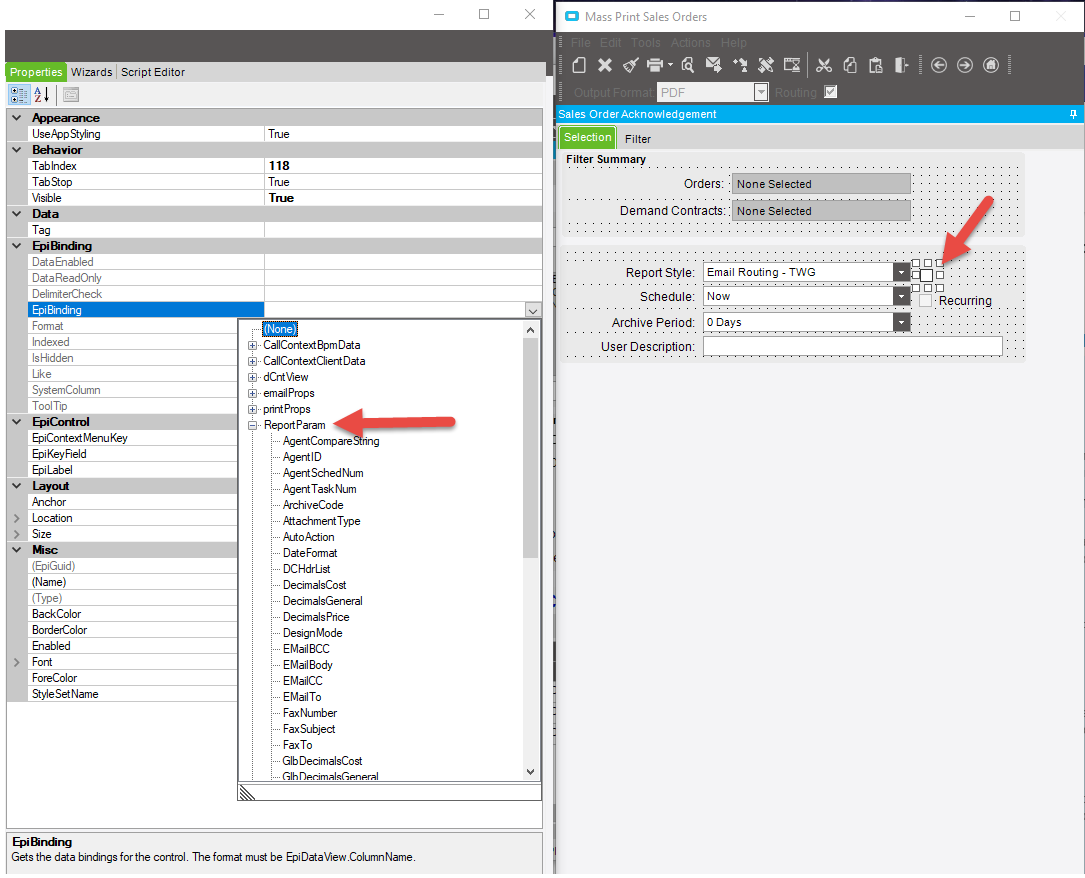

I have read that this needs to be performed in the Print Menu Customization using edvReportParam
I have no idea how to code this, does anyone have some example code to help me understand how to use this functionality, or is there a better method?
I’m not familiar with modifying that ReportParam dataset. The way I’ve seen it done / do it is to save it in some variable in the CallContextBPMData, then add the CallContextBPMData temp table to your SSRS reports dataset query.

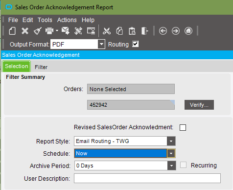

I am wanting to add parameter to the print report screen.
Revised Sales Order Acknowledgement. True/False
If the user selects true, I need to have the ssrs report texboxt show Revised on the report otherwise it will be hidden on the report.
