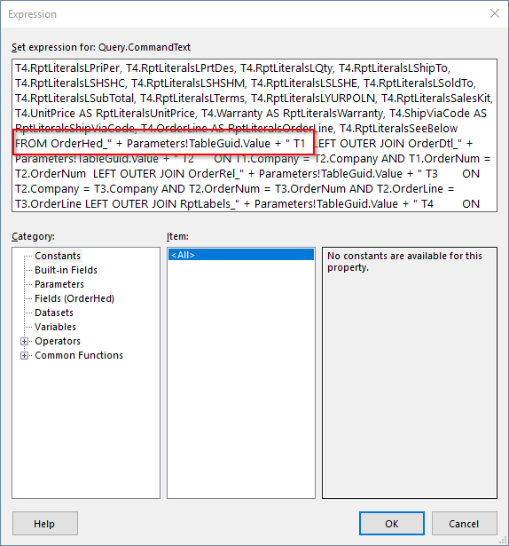

Check the SSRS query statement and verify that OrderHed is aliased as T1…
I figured it out. In the SSRS, I had the tableGuid set to a default. So, once I removed that, it went through just fine. Feel like Newb doing that! :sweat_smile:
