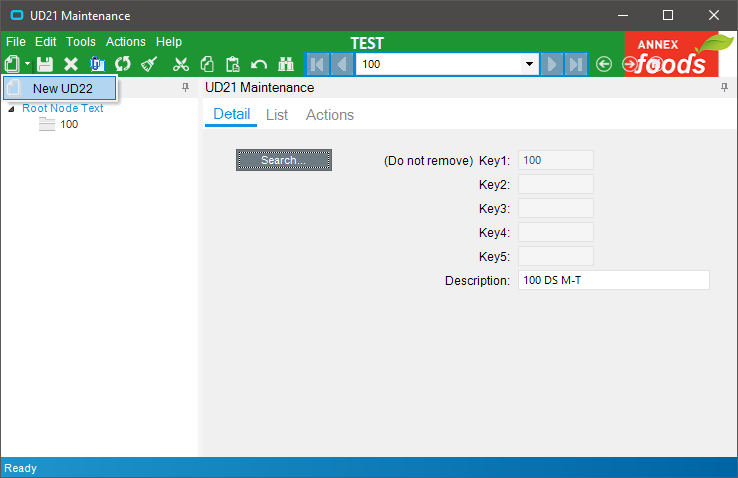

Hello everyone. I found a similar post about this here but, there was never an answer posted. Instead the user put buttons on their screen to Add/Delete as a work around. I would like the new dropdown and file->new to work. I have a vanilla screen with UD01 as the table, I add UD02 to the screen using the wizard. The binding is there, updating is there, but the New button does not have the tab icon to add a new UD02 record, nor is there a File->New->NewUD02.
What gives?
Wizard Code (again, I’ve changed nothing the wizard created):
