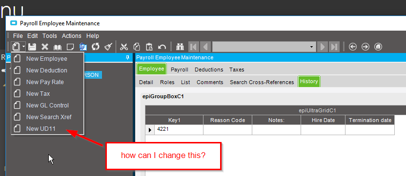

I want to add a UD table as a child table. The wizard did pretty much all of the work, and I have a grid that I can add rows to. Now I want to change the menu words so it makes sense to the end user.
First I tried changing the words from the string “New UD11”. While it changed it in the menu, it also made the the new button not work (it wouldn’t add the new row). Is there another step that I need to take to make that work? I can’t see anywhere else where that string is used.
I think you can find the tool that it adds, which should be the same as the “AddText” and change the caption.
if (this.baseToolbarsManager.Tools.Exists("New UD11"))
     this.baseToolbarsManager.Tools["New UD11"].SharedProps.Caption= "New Caption Here";
I haven’t tested it so I’m not 100% the code will work for captions but I used similar code to hide the tool for certain users.

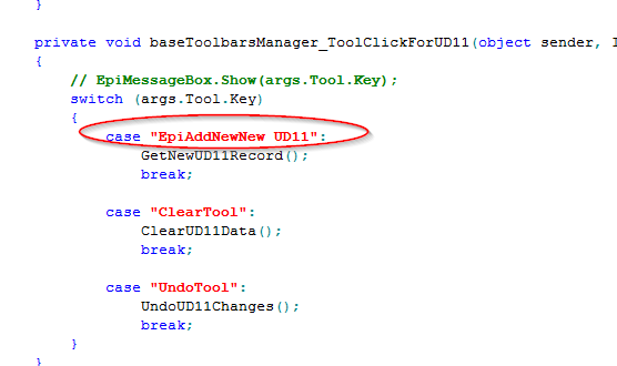

Yup that’s cause there is a Case Statement in the code (look for it) which uses the New UD11 as part of the Case.
So either change the caption (as @caleb.grundmeier mentioned) or change the name in both places. Where you point out and in the switch statement that calls GetNew()
I looked, and I still can’t find that case statement. If I search for “New UD11” it only shows up once in the whole script, which is where I show it.
Is this where it is? If it is, it’s throwing me off because it’s not the same string.
Edit: That was it. Seems goofy but it works.
The end is the same they append EpiAddNew at the beginning
