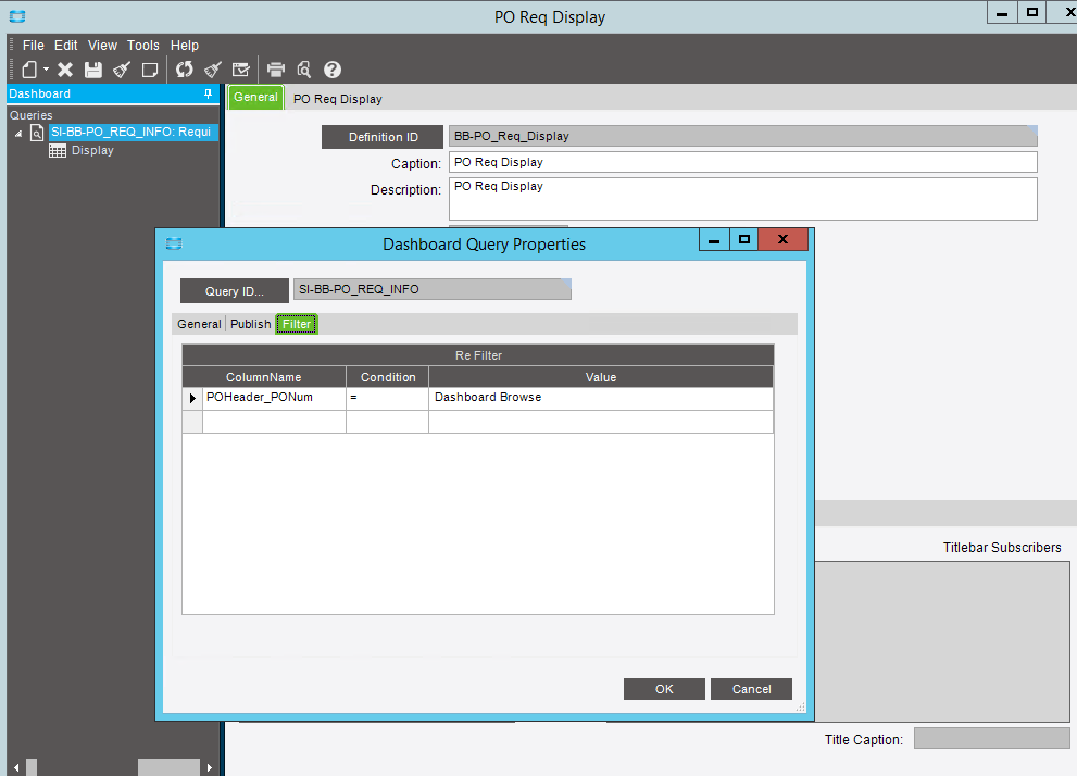

Hi Team
Trying to do something similar with the Quote Entry screen
However I keep getting the error
Warning- Embedded Dashboard invoked as a Subscriber, but there is no Filter defined for the Published columns. Please notify system administrator.
I have defined the published columns and inputted the filter to them from the drop down
I was hoping just to use the QuoteNum and QuoteLine as the only key, as I want to have a list of all the materials in that Mfg Details for that Quote Line.
Any help would be greatly appreciated
This video helped me get past the subscriber error message.
