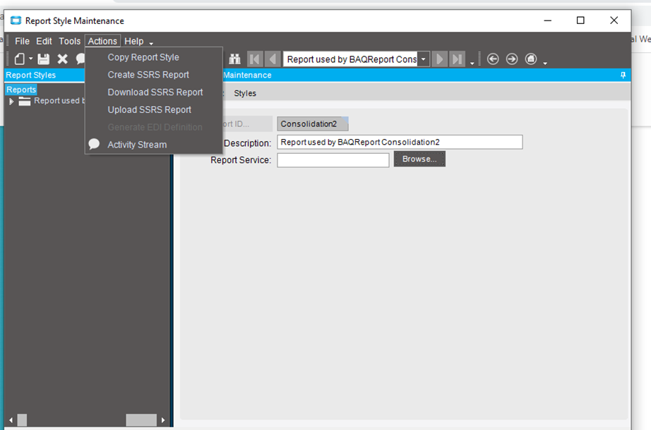

Go to Report Style Maintenance. Find your report style. Click Actions > Synchronize Dataset for BAQ Report. I think this used to be a button on the screen, but they moved it to the action menu. That should be the last step for you. After you sync the dataset, download your report rdl again, and it should have the fields you added.
Hi Nate
i do not see that option anywhere in Actions or a button.
Down on the ‘Styles’ sheet, select the Style until you see the Styles tab populate with data, then on the Actions Menu, I believe.
Hi Michael
I went to the Report Style Styles Tab and went to Actions but that function is not there. I have version 10.1.600 if that matters.
There’s your button right there! Sync Dataset.
Thanks for all of the help. Works like a charm!
