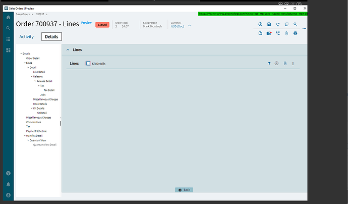

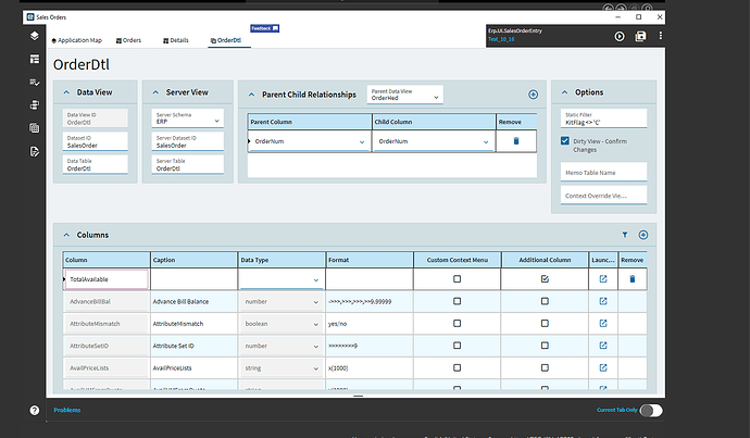

I created a fresh layer, the data , gridlayer options I could not see. I clicked on DataView , pulled up OrderDtl , and added a new column / field TotalAvailable. See below.
Saved , Ran , NO lines show up after adding a new column to the grid without trying to tie any data to it.
Am I missing something fundamental with Data , Grid Layer ? these option I could not find in any menus.

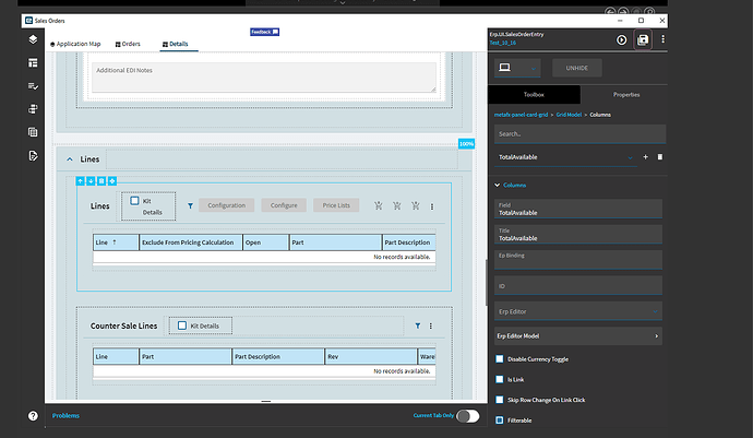

You have to click on the grid. It’s in the properties for the grid.
Start over.
OK , investigating further on the data , grid layer , steps to adding a column , I found the path of adding a column via the properties instead of the dataview ( using the + to Add a column to the DataView.).
Saved , Run , and the Lines DO display without data binding to the New column / field. I will continue with the testing , binding my BAQ field to the New column / field.
If this does resolve my issue , I do appreciate your patience with me. I hope this thread helps others trying to Add a Column via the DataView Add option.

What solved the no lines issue for me was where I added custom field to the Grid. Not in the Dataview , but in the properties. Read through that portion of this thread to see if it helps you. (Solution in the response from other member.)
