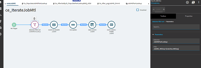

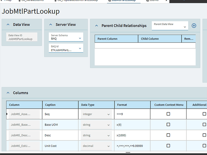

I am at the iterate step where I have the dataview-filter-set. When I add the widget, my BAQ results table blanks out. :frowning:

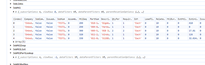

Everything looks good after the LoopUp BAQ event. JobMtlPartLookup table has data!!!
then the widget is added.
Then the table disappears.
Any ideas on what can cause this? Only thing I haven’t tried is to make the BAQ only two columns. Might try that in the meantime.

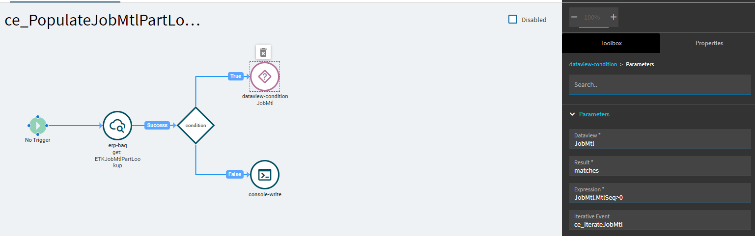

Show me how you set up the dataview-condition widget as well as what data is in the matches table by using the CTRL+ALT+V
How can we see the matches dataview? It doesn’t show up.
It’ll be up in System Dataviews.
Is it not there either?
Think I found the issue. The column being looked up is an integer.
tweaked the dataview-filter-set parameter to: note the lack of quotes
JobMtl_MtlSeq={matches.MtlSeq}
magic it worked.
