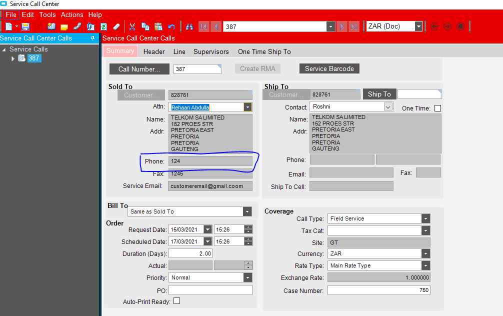

On the service call center there is a field called Phone.

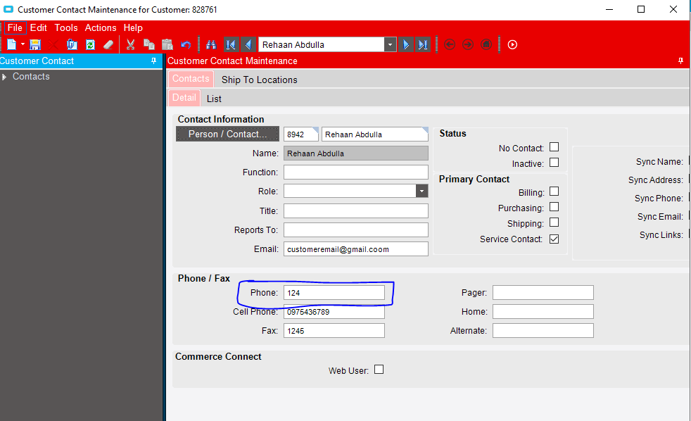

This field brings through the phone number on the customer contract entry.

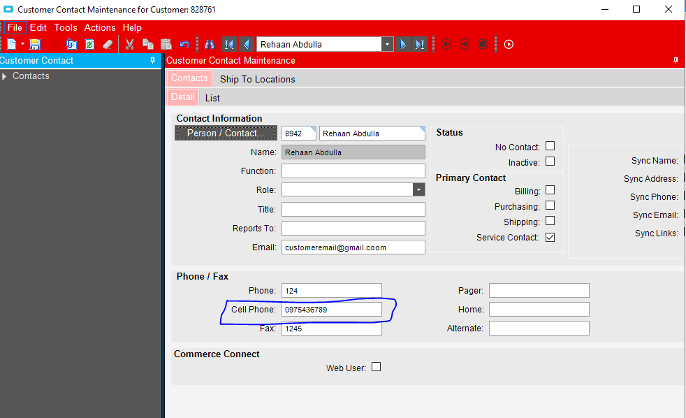

However I require the Cell Phone number to come through to the Phone field on the service call center
That would mean I would like the 0975436789 value to be shown in the Phone field and not the 124.

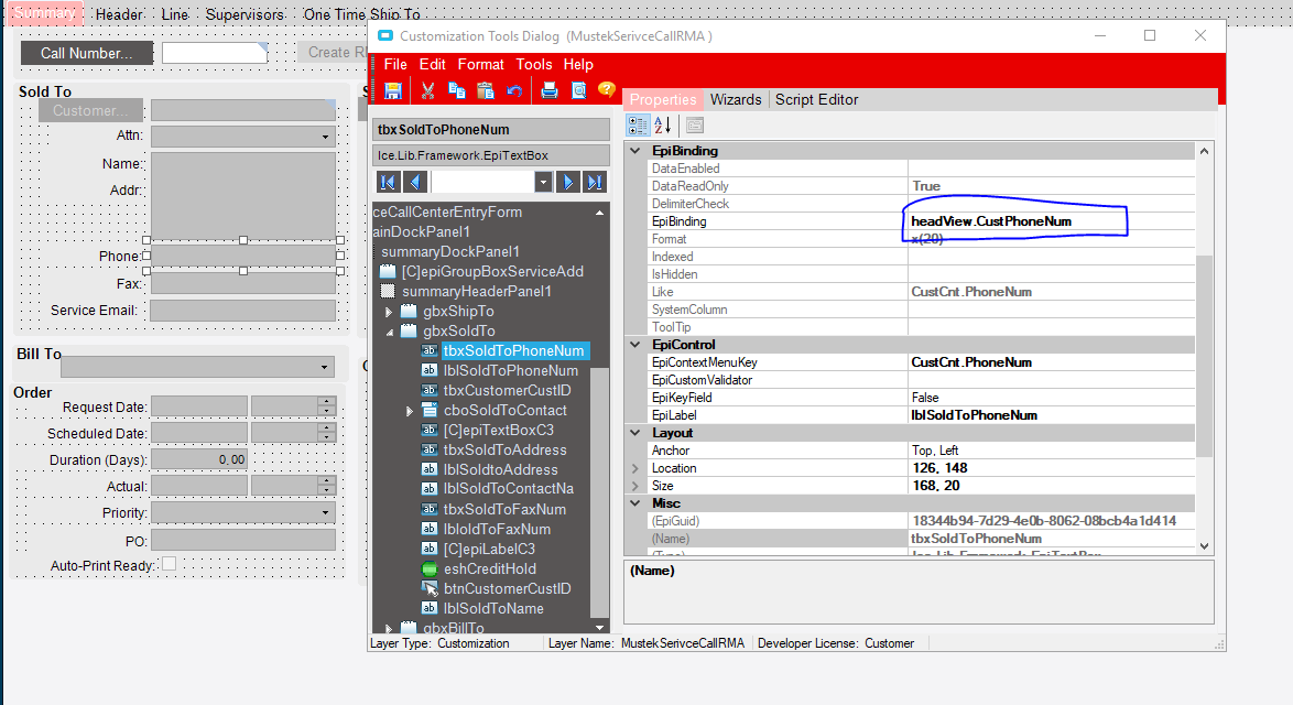

I have looked up in the Headview where the phone epibinding is currently and there is no cellphone number column. I was wondering if it is possible to add a column or table so we can reference that field?

To just add the column to the data view, use the Form Event Wizard to make a handler for EpiViewNotification, and your desired View. In my example it is on the POHeader of the PO Entry form.
The wizard will make the function, which you should then change to something like:
private void edvPOHeader_EpiViewNotification(EpiDataView view, EpiNotifyArgs args)
	// view.dataView[args.Row]["FieldName"]
	// args.Row, args.Column, args.Sender, args.NotifyType
	// NotifyType.Initialize, NotifyType.AddRow, NotifyType.DeleteRow, NotifyType.InitLastView, NotifyType.InitAndResetTreeNodes
	if ((args.NotifyType == EpiTransaction.NotifyType.Initialize)){
		if ((args.Row > -1)){
			if (!(edvPOHeader.dataView.Table.Columns.Contains("CellPhone"))){
				edvPOHeader.dataView.Table.Columns.Add(new DataColumn("CellPhone"));
				edvPOHeader.dataView.Table.Columns["CellPhone"].ExtendedProperties["ReadOnly"] = true;
				txtCellPhone.EpiBinding = "POHeader.CellPhone";
Take note that the NotifyType was changed from what the wizard creates.
This requires that you added the textbox first (its txtCellPhone in my example).
All that does is add the coulmn to the dataset and bind the text box to that column. You still need to set the value of that column. How do you plan on fetching the particular Cust Contanct?
