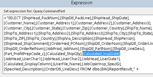

Within the SSRS report builder, I have opened the baqreport results dataset properties:
And added the field into the query
and then manually added the field
Saved the report and then have the error in system monitor:
Program Ice.Services.Lib.RunTask raised an unexpected exception with the following message: RunTask: System.Web.Services.Protocols.SoapException: An error has occurred during report processing. —> Microsoft.ReportingServices.ReportProcessing.ProcessingAbortedException: An error has occurred during report processing. —> Microsoft.ReportingServices.ReportProcessing.ReportProcessingException: Query execution failed for dataset ‘BAQReportResult’. —> System.Data.SqlClient.SqlException: Invalid column name ‘Calculated_InspDate’.

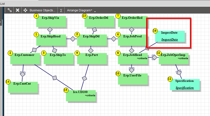

Can you share your BAQ Query also?
Hi
Modifying in test environment- noticed the report was using a shared datasource from live environment so corrected that, still no joy-
baq query is below - the red highlighted part is the table i added
with new added field:
