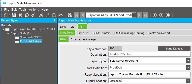

I have the report style as follows:
Can it be the fact that the BAQ, being the source of the dataset for the original report, and the report name changing as a result of copying are disconnected?
Should I create a copy of the original BAQ, modify it with new fields, and then create report from that? OR just put that new BAQ as the data definition in the Prodlbl-Etables report style?
