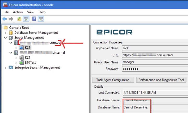

I am installing K2021.2 on our test server and trying to move over to https binding in the process. I am having trouble setting up the https binding.

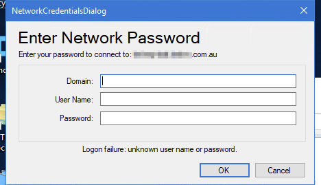

I can deploy the new application server but when I try to connect to it in the admin console I am getting dialog requesting network credentials. When I enter credentials and click ok it comes back. most annoying.
I have a cert installed on the server from a trusted authority, with the name “server.company.com.au” and that is in the binding in IIS. I have also created the Epicor server in the admin console as server.company.com.au to match the cert. Note by default it wants to create the Epicor server as server.company.internal.

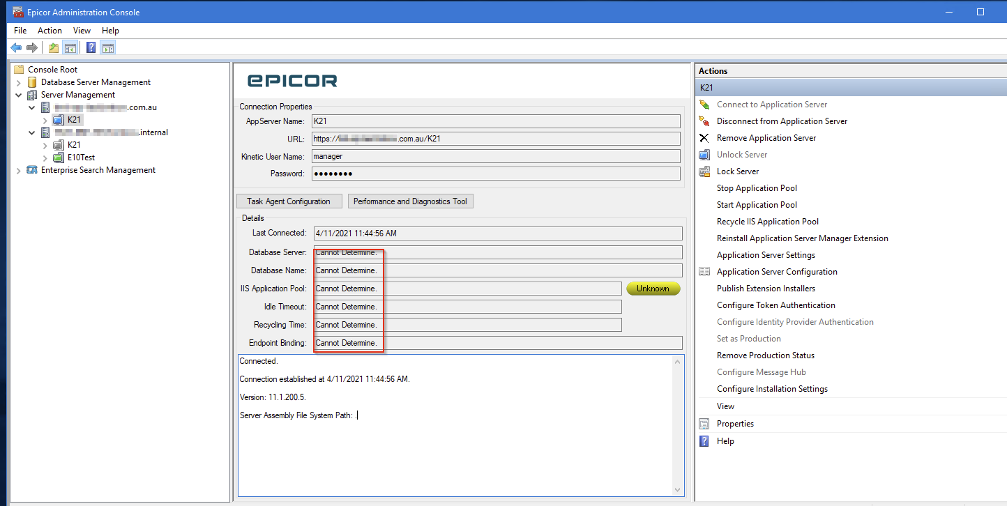

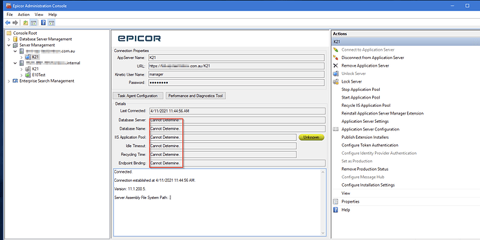

If i cancel the credential dialog enough times it seems to connect but is missing details.
I also tried to create another Epicor server at server.company.internal and register the app server under that. It was able register it but not able to connect to it - I assume because the FQDN is different

This is definitely a Windows binding prompt (asking for Domain). Any extra modules installed that are using Windows Authentication?

This is a basic Epicor install - no data discovery etc installed. It is setup for username authentication ie not windows.

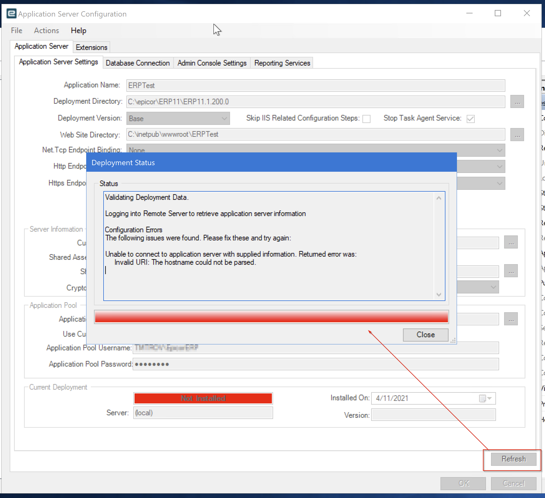

I noticed that if I try to edit the App Server all the fields are disabled. There is a refresh button and clicking that give this error. (I deleted the previous app server and started again).

Does your Windows Server FQDN and your Application Server/Certificate Name “server.company.com.au” match? If they don’t, that’s why you getting the pesky “Network Password” pop up message. EAC is looking for a computer on your network with that full name and never finds it. You don’t get this issue when your server uses a self-signed certificate because it takes the current server name as its certificate friendly name by default and matches (\servername can be found on the network).
You need to ensure that the certificate friendly name resolves to the Windows server fully qualified domain name where Epicor/IIS is.
FQDN = Computer Name + Primary DNS Suffix
