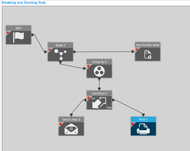

I am getting ready for user testing of our AR Invoice form process and I setup a group by to to group on CustNum. As you I hardcoded my email in the send email action so all invoices are sent to me only.

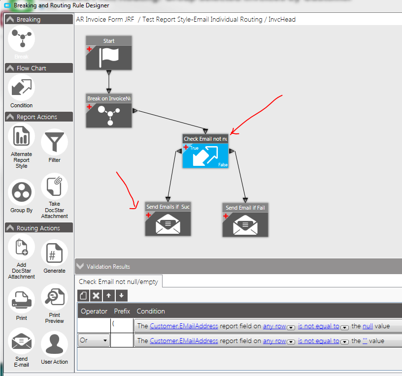

@kfierce did you run into any trouble with the conditional block?
I have a condition after the break to check the Customer.EmailAddress for both null and empty. If it’s not null or empty, it should send the email to the left.
The problem is, I am testing with customers that have no email and this still evaluates all the invoices down the “success” path and never down the “fail” path
Since null and “” are two different conditions, the logic states not equal to null OR not equal to “” will always be true. Should be not equal to null AND not equal to “”.
Thanks Brian, I tried that and it performs the same way. I also tried removing the pre/post fix to no avail
How about swap the logic so FALSE if = null OR = “” and TRUE otherwise?
I also tried that, but then they both route to the “fail” side of the condition. It’s like it’s not actually evaluating per Customer but it is breaking on invoice. I also put in a message variable to show the contents of the customer.EmailAddress field and they are different (one is blank, one has a value) so the data is correct

My send email condition looks like this and I have no problem with it. (saw it setup this way on a webex):
The CustomerEmailAddress report field on any row contains the @ value
With that any blank emails will goes down the false patch and gets printed on a network printer to go snail mail.
