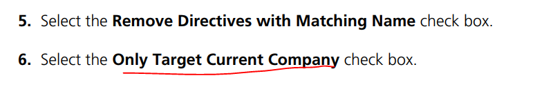

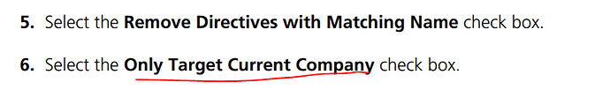

The Epicor Instructions are somewhat lame, their .cab is bundled with items that should be deployed per-company and into your Main Company once… It definitely isnt Multi-Company friendly. If you have multiple AppServers they also miss that. Their instructions state to Target Current Company, which deploys Menus and Dashboards not with All Companies; hence again not Multi-Company friendly.
If you use their instructions you will get errors. Since for example the Menu Elements can’t be installed again and they exist in the .cab
If you throw out their Instructions, the install itself was not bad. I Deployed it all to our GLOBAL company and then created a seperate Extension Set .cab which I deployed to all child companies.
I also took the Server Files and added them to all my App Servers manually.
The Client files I did manually as well because the .cab does not create the structure they mention in their docs.
