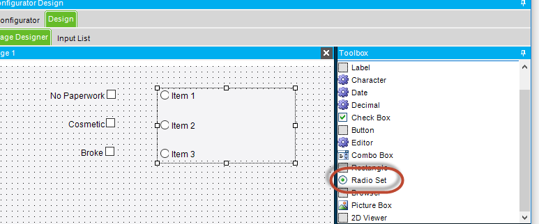

I have moved away from using Checkboxes for the most part and use Radio Buttons with Yes/No as the choices. Reason is you can make it required so you get an affirmative choice. I’ve had a few clients that ask me to make a checkbox required, once they say it out loud they realize what they are really asking is to ensure the user has affirmatively decided True/False. With the radio button cleared to begin with the user is required to affirmatively chose Yes or No.

When I want to conserve screen space, I use a combo with three possibilities: “Choose One”, “Yes”, and “No”. You can then test for “Choose One” to prevent the page from moving on.

Yes for some reason I call them Radio Buttons. Also check out that they can be horizontal which is how I use them when Yes/No is the choice.
