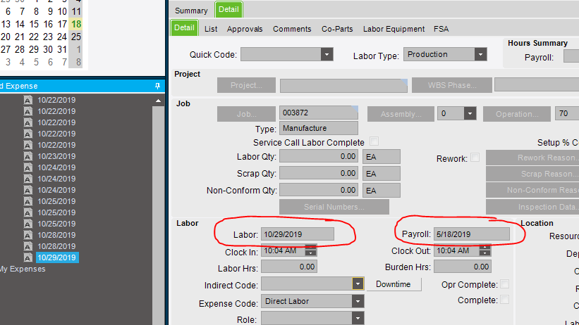

After clocking in/out to a job via MES today (10/29/19) or any day, the payroll date is always 5/18/19. There must be some configuration issue, I just cannot find what it is. Thanks for the help.
You are clocking in/out of a job(LaborDtl) but the LaborHed record is for the day(5/18/2019). Clock out of the day, and then clock back in.
We tested that. It still shows that payroll date of 5/18/19
Have the employees clock out of MES. I believe they are lock in to MES but haven’t clocked out of MES
